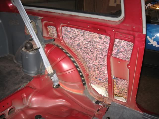

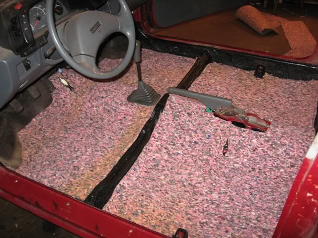

On the floors. I removed all the old padding. Used a layer of peel and seal, layer of carpet pad and another layer of peel and seal.
In the quarter panels and rear, including the trunk (Vert), I used peel and seal, spray foam, aluminum flashing cut to fit and covered with peel and seal and screwed over the body panel spaces.
window peel and seal is thinner than roofing peel and seal. both bought froms Lowes, both almost comparable to other "specialty stuff" and cheaper.
Lot of trouble--allow 3 times as much time and twice as much material and 3 times as much $$$ as you think.-----But VERY EFFECTIVE.
