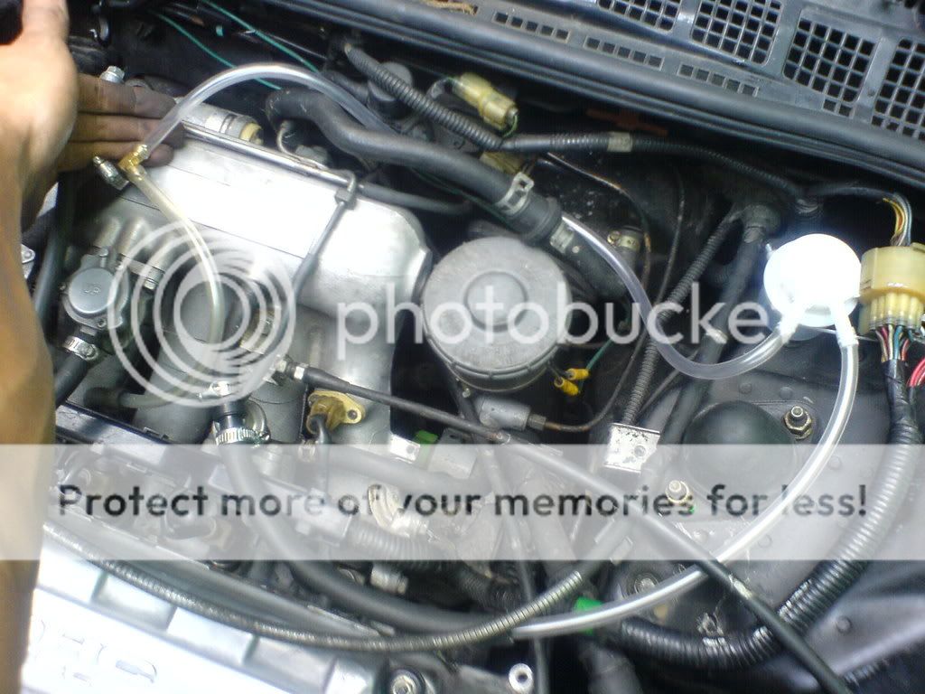

Manny
Yes! a Costa Rican member
Here's one I made cheaply on my previous Acura... main advantage is the replaceable filters. Note that my PCV was located too close to the intake
My point is you can use those gasoline filters which has too many sizes and forms, so you can get different inlet and oulet configurations. Probably not the best one, but worked perferct! Later on I just added another filter and got two in a row...
I haven't done anything similar to the little "Nano" since the filter plate is damn clean... makes me think it is not necessary. But catch tank for me is as necessary as an oil cooler on any car...
Here the pics:
I hooked up the valve cover and PCV hose together...
And that was the final thing... Just took me 15 minutes to install.
Manny
You should be surprised how well this gasoline filters work... later on I finally added another one, so got two filters in a row and no possible oil gases on the intake.
