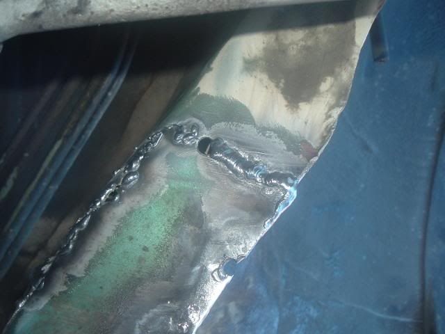

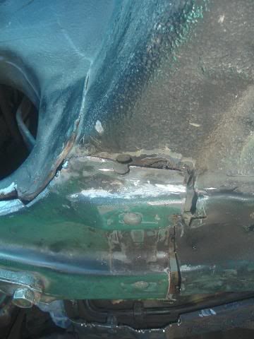

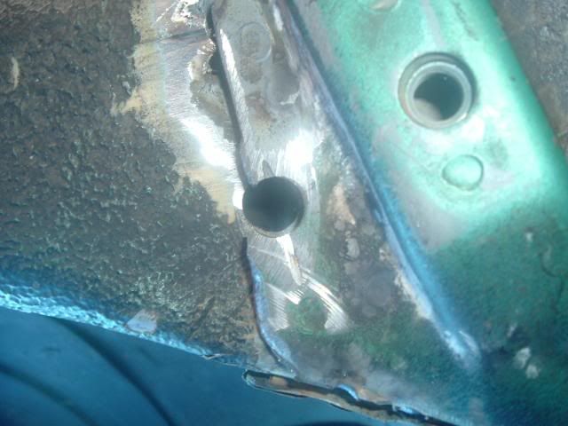

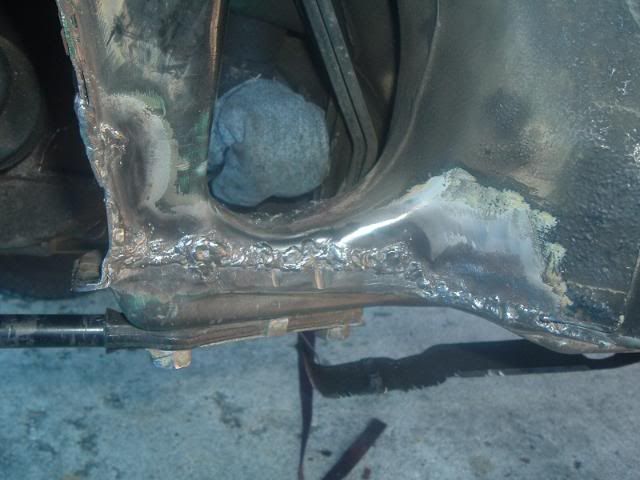

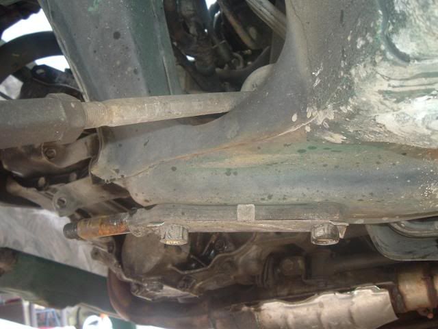

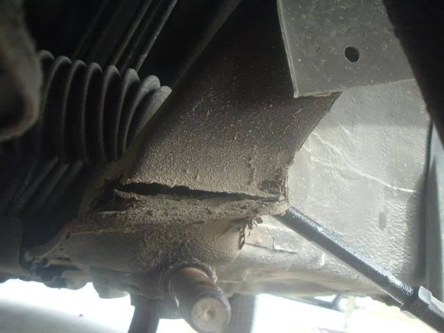

Welding through rust is a bitch. The frame extension is/was rusted into the upper portion pretty bad.
Here is the out side wall. The bubble gum parts are where I was trying to tie the new to the old through the rust.
Not to worry, I have a plan.
Grind smooth and apply a fresh piece of metal to re-enforce and tie upper and lower portions together.

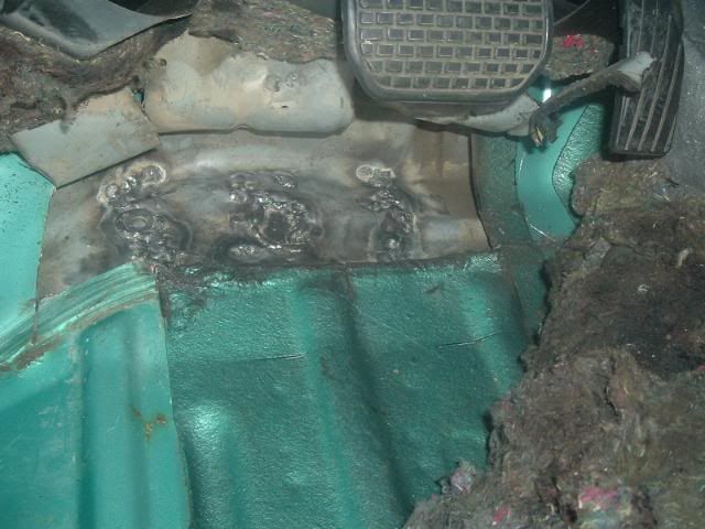

The inside of Bobby's driver side footwell. I cut open the floor to access the inner panels so I can weld the new stub to the original superstructure. I have to get through this and put his floor back together. I told you I had a plan.
Oops, a hole in the floorpan. Hey we have a whole other floorpan to plunder, pillage, borrow, or otherwise get parts from.

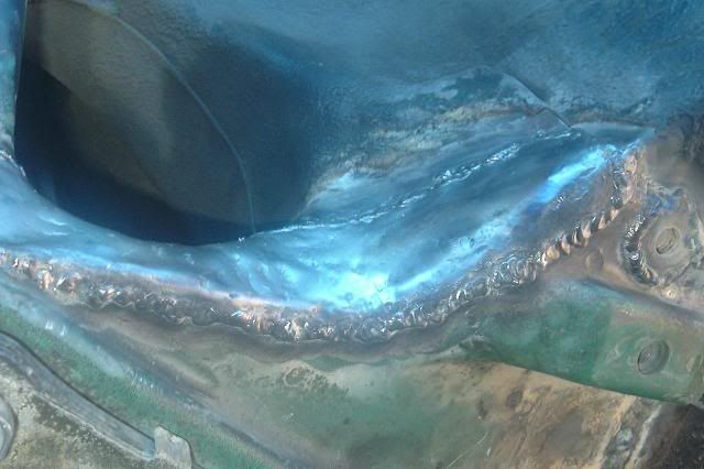

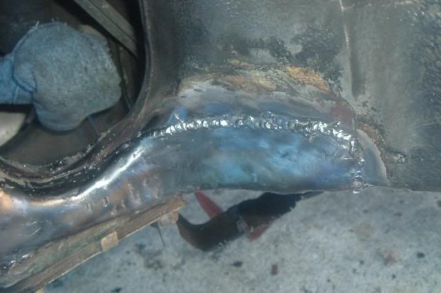

Some fresh 16 gage metal added to the outer edge. Donated by one of the guys in the shop.
He gave me a lot of fresh metal to use, so I will.
The bottom of that same piece. I welded and hammered till it fit where I wanted it.
On the right is my line up hole with a frame washer welded into the metal around it.
Why? you ask. One of the guys at the shop suggested that I use that hole and a bolt with washers to pull the pan into the stub. It worked well and I welded the washers there for added density.
The top of that piece as well. A little heat goes a long way and I was able to form it around the original horn as I went along.
Of course having a 24oz dead blow ball peen don't hurt neither.

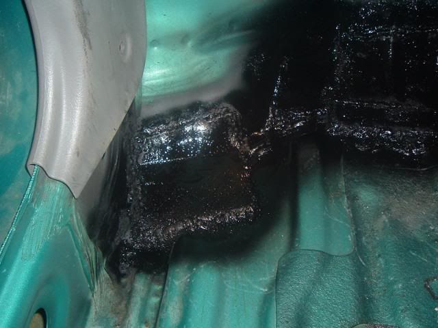

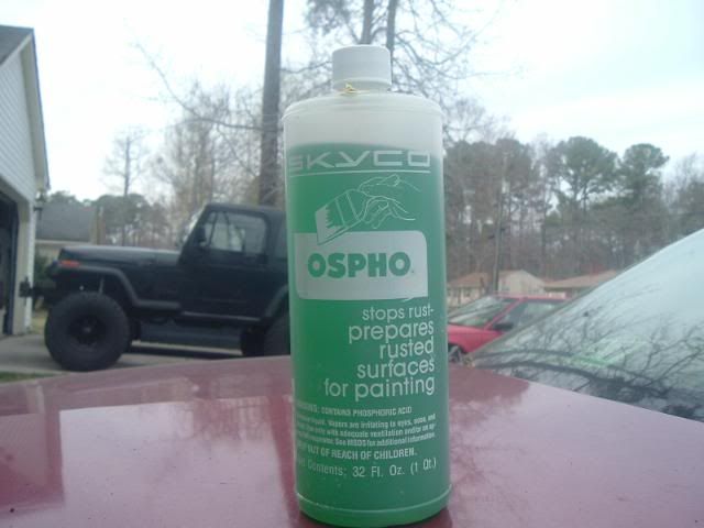

"Ospho" the be all and end all of rust prevention. We use it in the shop after repairs to ward off rust in frames.
Pour it in and let it set. It turns rust into a hard primer like coating. Iron Phosphate. Sandable, paintable.

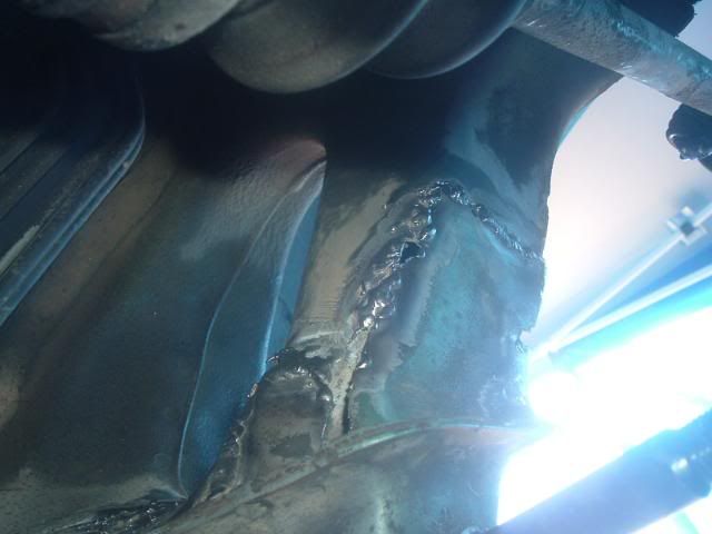

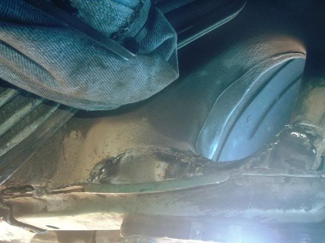

The inside of the superstructure. Where I burned through the pan to tie the new stub to the old Unibody.
There is no pattern, I just went by where the rust created usable holes.

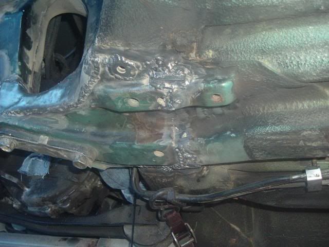

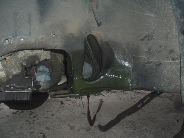

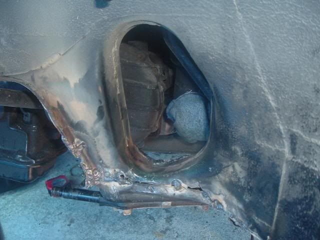

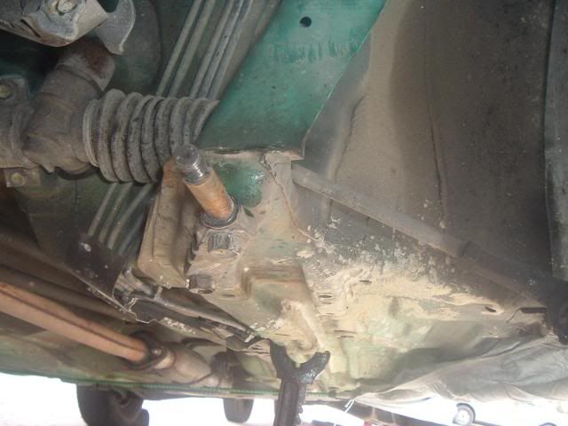

A shot under the car where the new stub meets the old. Also shows the 1/4 plate steel used as a support and
to tie the new to the old. Had to grind the inner portion away for the rear control arm mount to sit flush in it's new
home. You can see the ratchet strap holding the brake and fuel lines away from the repair area.
Painted with self sealing primer.
