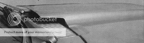

Since my tower strut messed up my air cleaner I've been thinking about the reverse induction ala NASCAR. There is pressure at the hood/windshield intersection ,where the vent system draws in air, and that is a lot of air. Plus being off to the side it may not detract to much from the vent system. Take a look at: Super Scoop

You only need to worry about that if there's a possibility of the intake being under water. A lot of guys run the intake piping up front and have the air filter in the bottom grill opening. If you drive into a puddle over a foot deep, then it will suck up water and grenade the engine. Rain shouldn't cause a problem, just standing water. The stock intake is in the wheelwell, a minor problem with the plastic liner would have the tire constantly throwing water at the intake. If you're talking about true cowl induction, a reversed hood scoop, you have no worries whatsoever. |
