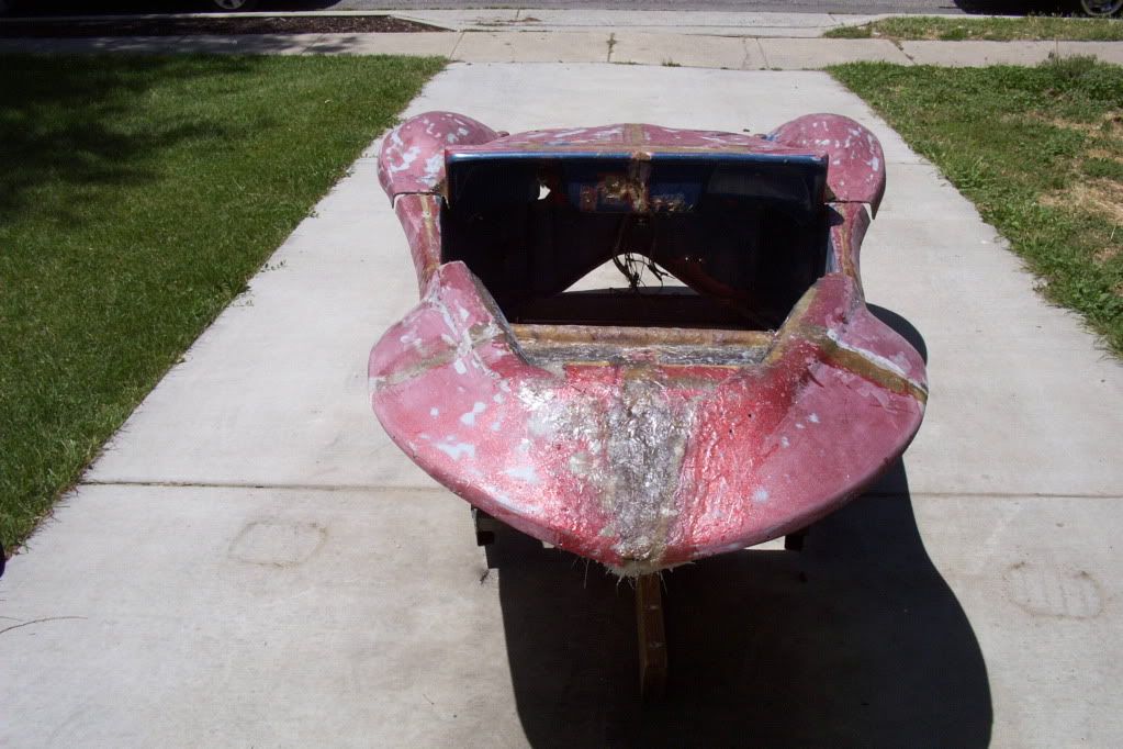

Here are some Pics of the bodywork for the Metro 3 wheel project. OOPS...... Smart enough to attempt to build a car, but can't figure out how to post pics. If someone is willing to post pics for me, I will send them to you by email. Anyway, pic one is the main buggy body that is shortened 8" and narrowed 4" then tapering it for only one rear wheel. pic two is the front end view with the one piece fender and hood assembly attached pic three shows a view from the rear. This is loosley based on the Corbin Raven. |

http://geometroforum.com/topic/629098/ I suggest getting a free account at photobucket.com and post them pics and link them here. |

| ScooterPOD | Aug 18 2009, 03:54 PM Post #5 |
![]() ![]() Edited by bogs, Dec 30 2010, 12:46 PM.

![]() Enough said. |

Thanks for the help with posting the pics. The framework is being done now and should be rolling in about a month. It is a single seat super lightweight. I have 14" 3 spoke wheels, but will need some tires, or... I also have the original 12" wheels and tires. Why re-invent the wheel. What parts would be recommended for making a 70 mph car that gets 70mpg??? I do have access to some XFI parts. |

Back in August I posted that the buggy would be back home in a month, and....... well its now home!!! about 5 months later. Remember, ANY PROJECT TAKES TWICE THE MONEY AND FOUR TIMES THE TIME !! Most of the bodywork got broken or cut and modified during the constructing and will now need to be refit and repaired. It starts and runs, but needs a permanent location for the battery and fuel tank. |
