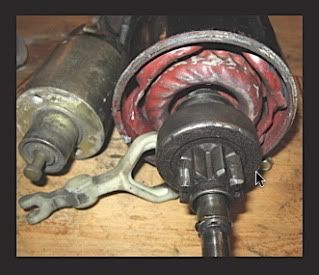

My starter just went out too! It just stopped, couldnt get it to crank again, no matter what I tried. At first I started chasing suspect wiring trouble... quickly decided it's far easier to first disconnect the small wire on the starter, then connect a jumper wire to the battery pos (+) terminal, and touch the other end of the jumper wire to where the small wire connects on the starter..(make sure the car is in neutral/park). The starter should give a response...(mine didn't). it's also easier to just pull the starter out altogether, then test it with jumper cables...(I got some serious grinding noise when I connected battery to the motor terminal) Took the starter apart, found the thrust/throwout bearing to be the source of the grinding noise.(pics below)..... a new starter req'd, regardles of any other troubles...$65 at Kragen's/O'rielly's, and 3 day wait for delivery... ...guess I'll start working on replacing the floor carpet while waiting.... 93'vert lsi - starter: ![]() dry/grinding - starter thrust/throwout bearing:
