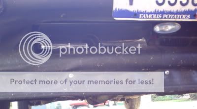

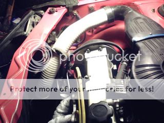

As promised the new and improved collector made from a Shop Vac floor attachment. The duct tape on the collector was holding on a temp. flap, I noticed no change. There are 3 45 deg bents in the tube now and the white section of hose is smooth on the inside. Yes, I shortened the snorkel and am contemplating how to seal it better than Duct Tape. ![]() ![]() ![]() It still has a louder, more gutteral sound than the smaller 4" round collector. I moved the plate up out of the direct air flow.

FOG
looks like a work of art ... in progress i hope it improves fuel economy , i am anxious to see test results .................... those lurkers with marginal cat converters should have a look at that insulation on the exhaust , that can only improve cat converter efficiency and by so doing reduce emissions without any decrease in performance Edited by mwebb, Sep 25 2009, 11:12 PM.
