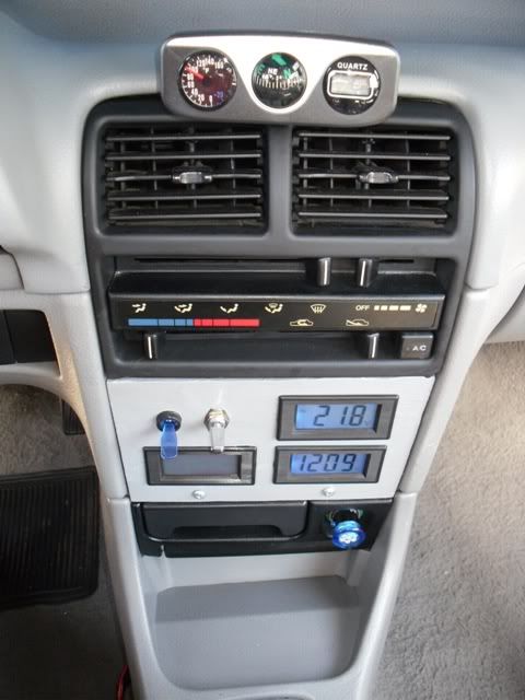

I'm experimenting with this right now. Check out my personal blog on this site. When I toggle the alternator 'off' (belt still attached)...you can hear the difference in workload on the engine. Right now I'm leaving the altenator on while coasting down hills and flip it off when I'm driving level or climbing. Here's a pic of my mod control panel. (silver switch is alternator disconnect) Batt voltage displayed on bottom right and solar input on top.

Hot off the press. My first fill up since using my newly installed alternator/generator dissable switch set a new MPG record for Bullet. 62.93MPG. I only ran about 80 miles since the installation was complete so I'm hoping to get maybe another 1 or 1.5MPG that this in future tanks. I love this stuff!
