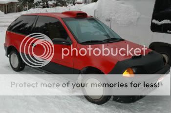

| Bad Bent | Dec 8 2009, 01:30 AM Post #6 |
Coroplast is a great idea Coche Blanco. I don't have a sign shop in town so I used garden separator material, 4" wide, 20' long black plastic. Made some aluminum "L" brackets and bolted it on the lower lip for an air dam.

Metro on the brain
Seems like a pretty simple fix "bed bent" but looks good. Thanks for the advice and the pic. |
