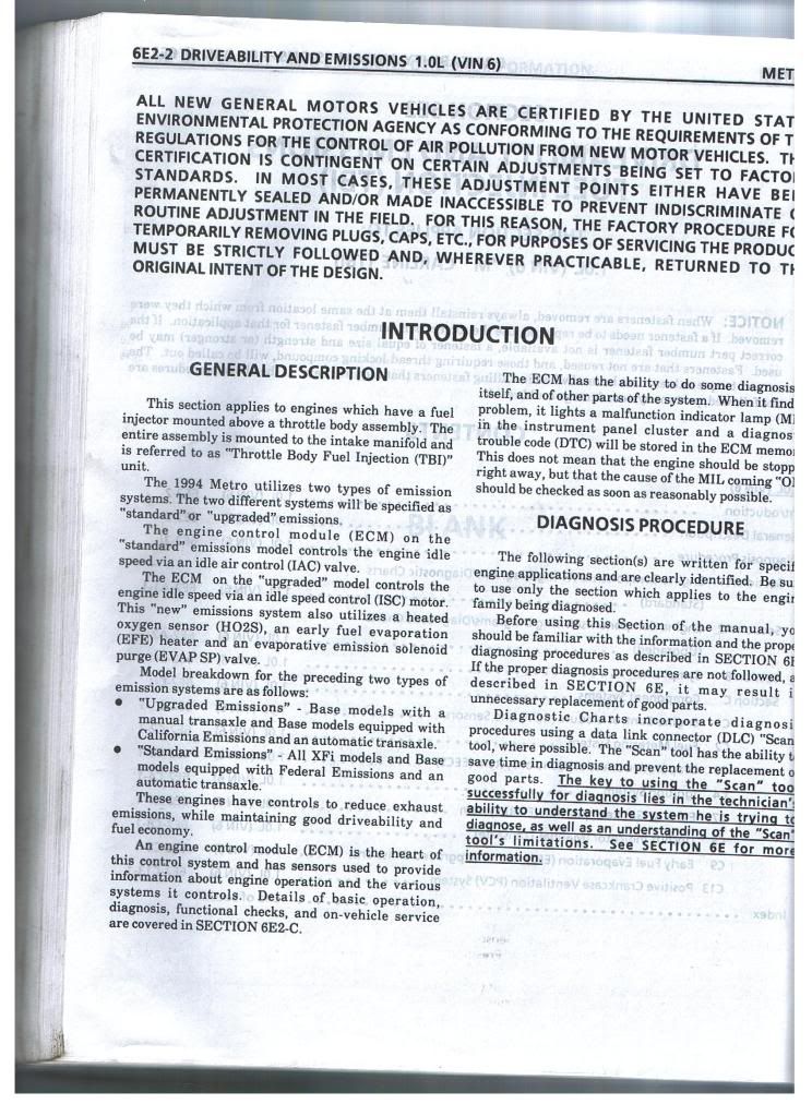

1994 old body and 1995 new body have heated o2 also (and other goodies, I don't know if they recieved a new computer though) Heres an the page from my 1994 Factory Service Manual explaining it:

1994 old body and 1995 new body have heated o2 also (and other goodies, I don't know if they recieved a new computer though) Here's an the page from my 1994 Factory Service Manual explaining it:
some early systems have heated 02 sensors
ok
but
the OBD2 ECM S operate at faster speeds , they make decisions quicker ,
so they are more efficient at keeping up with changes in operating conditions
i believe that
the system that can operate with feedback from a knock sensor to help manage the ignition timing map will be more efficient and provide better drivability and fuel economy and SURVIVeability
than
an experimental lean burn system that depends on water injection to prevent engine destruction that DOES NOT have a knock sensor or FEEDBACK from a Knock sensor to help manage pre ignition in a tampered with ignition timing map
