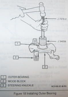

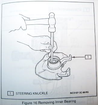

This maybe too late, if so then my apologies... also my scanner broke, so, fwiw... ![]() ![]() ![]() ![]() NOTES: - Pictures are from '94 shop manual... - You don't really need any "special" tools. - You do need to be very careful, to not scratch the surface that the bearings and seal set into. - Be sure to pack new grease into the bearings - Be sure the bearings are installed with their sealed side facing out (see the 1st pic above) - Dont forget the bearing "spacer". - Apply a small amount of bearing grease to the lip of the inner oil seal - The inner oil seal seats firmly on the inner wheel bearing |
