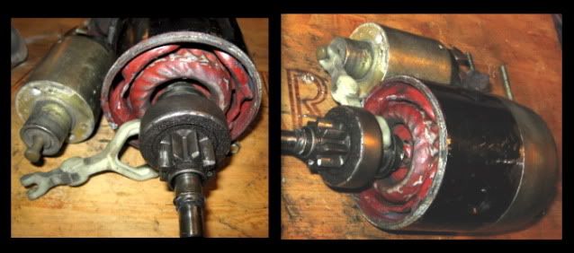

My '93/G10 starter was a tough one, for sure... lasted 186K+(original owner)miles, before it became toast... It happened suddenly, without warning, it just quit working! worked one moment, 3 seconds later, no work, no turn, just a click...! needless to say... the car wouldn't start... Tblshooting/testing was proving the trouble into the starter motor... removed and jumpered it directly to the battery...no spin, etc... tore it apart, found some insulation on the field coils worn thru, shorting the armature. Also found lots of fine grit/dust around the thrust bearing, and inner housing...(yep, is toast!)

The only "starter motor" related pics i could find...
The original starter motor, undergoing exploratory surgery:
