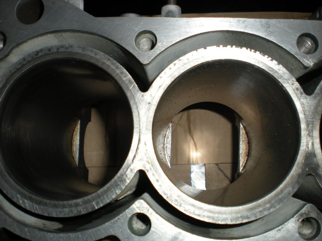

Hey Johnny, while were discussing cleaning gaskets off what is the best way to clean it off a block deck, the headgasket left residue on my block and on the top of the cylinder sleeves, scotch brite pads will not take off the "little dots".

Cordless drill with a wire wheel attachment works pretty good if no air available. Wear safety glasses!
OKAY??? Is a wire wheel too rough? After using it for a couple seconds I am noticing "pits" and little chunks of metal missing on the top of the cylinder sleeves? :banghead
Ignore the dirty cylinder walls.
Edited by chads4dr, Jan 29 2010, 06:19 PM.
Rooy
I was going to say something about being careful with a wire wheel on head gasket surfaces. It can remove metal, which would of course be bad on these critical surfaces.
But chunks is not what I'd expect. Don't know what to make of that, other than to not use the wire wheel any more. Maybe try a Roloc disc or just some Scotchbrite by hand.
Im at a loss, it doesnt seem possible..... I mean the wire is somewhat flexable and this is a huge chunk of aluminum. :x
EDIT: Maybe it was there to begin with? and the old headgasket was just filling the void, and the wire brush removed those bits???? Im just theorizing
