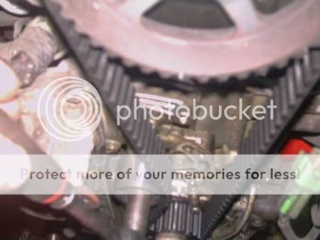

Your 1997 Metro 1.3L should have 5 small 8mm bolts..........
This will allow you to remove the belt pulley. Then you remove the timing belt.........
Then the large 17MM center bolt to remove the belt cog. The seal is behind there........
These images are from a 3 cylinder, but should be very similar.
