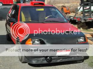

metroschultz
I have one. I will post pics soon, snow all over here.
Made from the lower spoiler of a mid 90's Chevrolet Blazer S10.
Dam# near a perfect fit.
I am getting ready to pull it off for the winter. It keeps acting like a dozer blade in the snow. (we don't get snow here, got 8 inches last weekend, calling for more this weekend)
Mileage increase? maybe 5%. No true A-B-A-B testing to verify. Mileage log shows increase, but also some decrease as well.
I went to 13 inch wide tires from 12 inch skinny tires at the same time. I believe they balanced each other out.
Next summer it is coming off and I will replace it with a full under-body panel.
Hope this helps.
As bogs suggested; Click this.
Posted ImagePosted Image
I got the edging material, 3 feet of 1"x3/16(?)" aluminum, something bendable (no vice), some bolts/round head screws and Nylock nuts/washers for maybe $20-$25 total. Made little "L" brackets, drilled a bunch of holes. I did not want to drill through the Le Bra and was not entirely sure this would work. Turns out it's break-away in snow and that's a good thing. ;) Well, I like the way it looks and I believe it contributes to better gas mileage. At least in theory, eh.
I was looking at ecomodder.com and the belly pan project, tho not perfect, netted ~2.5% or there abouts. The last post however noted that the various projects had each been under 3% but do 4 of them and I would conservatively say you got a 10% increase or maybe 5-6 mpg.

metroschultz
Feb 2 2010, 12:35 PM
Hope this helps.
Like this one?
