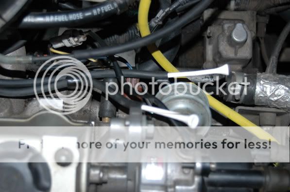

I would like to know were the intake manifold gas filter is so I can plug it up, and set the timing. It is a 93 Geo Metro LSI. |
| Bad Bent | Feb 13 2010, 05:25 PM Post #2 |
Technically it is on the #1 tube of the intake manifold, looking down on if, from left to right. I have always pulled the hoses off the vacuum advance on the distributor and plugged both of those vacuum hoses with golf tees. Just being sure I know which is which when reconnecting them.
