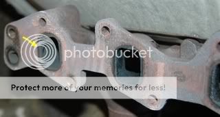

Just as a FYI here are two pics of the exhaust manifold. The first shows all three ports and on the left or #3 you can see the EGR porting and maybe a 1/8" layer of carbon build up;
In this pic, looking from above, the yellow lines show the 90o turn the exhaust gases make from the exhaust flow.
