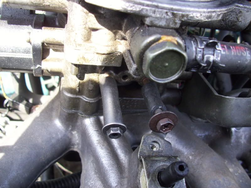

First, bottom of throttle body near the intake manifold, facing the valve cover/front of car there are two hoses that appear to be vacuum hoses that previous owner has blocked off. Should I bother re-connecting these hoses, and if so, where do they go
Pic of what I'm blabbering about-

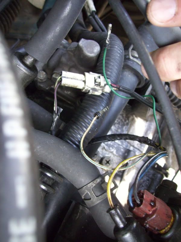

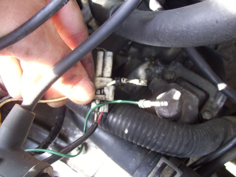

Secondly, there are two wires near the thermostat housing (ONE SOLID GREEN, ONE YELLOW W/ GREEN STRIPE) that have quick disconnect clips on the end that are not connected to anything.

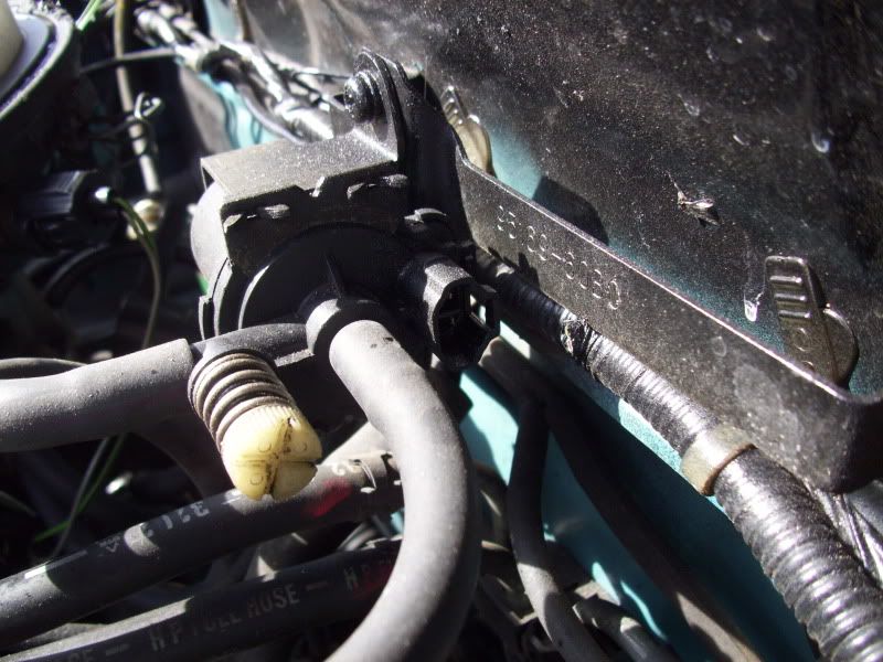

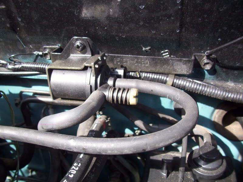

Third, there is a mysterious black box on the firewall with a large plastic set screw w/ a spring behind it with several vacuum hoses running from it. There is an electrical plug on the back of it facing towards the drivers side of the car. The inside of the plug is split in the middle with two contact faces, one on each side.

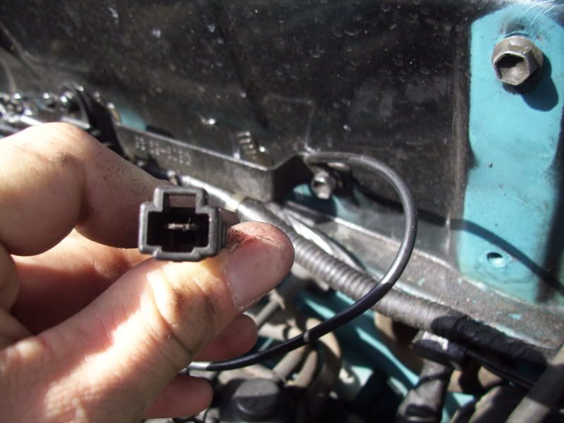

Lastly, there is also a solid black wire that appears to be a ground wire (looks factory, screwed into the firewall next to the black box in question) with a plastic housing with a single large male connector inside.

Check your distributor ground wire. I have one that likes to come undone every once in a while and looks pretty similar to the one shown in the bottom pic. Although I never notice a difference in running condition, I just open the hood and see it disconnected.
