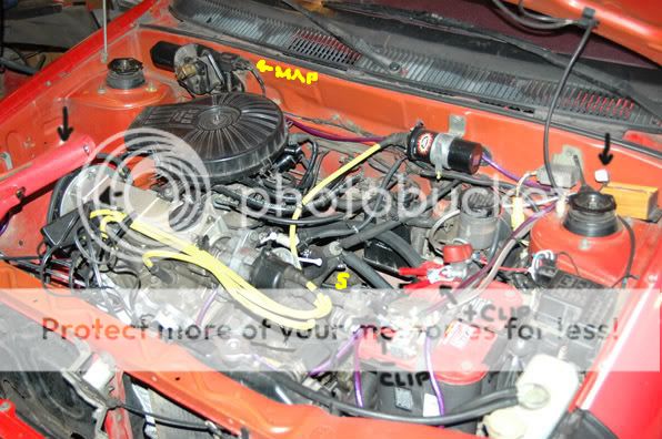

What do your spark plugs look like? Are they white, grey or black? When I did the engine swap in the Rocket. I missed a plug. It went to my map sensor. So it was running way rich. My new plugs were soil black. Once I found the wire I missed. It ran perfect. It was on the fire wall behind the air cleaner.
Thats what I found wrong with mine yesterday. My plugs kept smoking up and the check engine light was on. I ran the code down and it pointed to the map sensor. I looked over and found the vaccum line off. Not sure if I put it back on after rebuilding it or not. Either way she picked right on up after that. In my experience, map sensors make a huge differance if they are not acting correctly.
@enginedoc. I had the same exact problem. Hooked it up, and now it runs like a top
