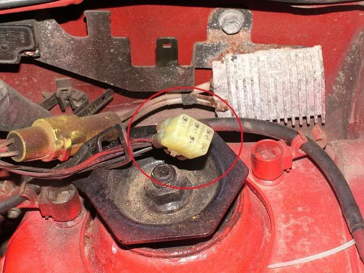

| Johnny Mullet | Mar 6 2010, 12:44 PM Post #46 |
Silver thingy next to circled plug..................
| oneofakinder | Mar 6 2010, 12:46 PM Post #47 |
Trying Hard To Like Metro!
That's the thingy with the fins on it I was wondering what the heck it was. Is there a way to test it? And that looks nothing like the 3 wire jobby the parts store has that they call an "ignitor". Edited by oneofakinder, Mar 6 2010, 12:47 PM.
| oneofakinder | Mar 6 2010, 04:31 PM Post #48 |
I found another one at the wrecking yard. Bought it just to test and compare, I took this silver box with fins into Schucks with me and they had NO CLUE what it was. |
| Jittney | Mar 6 2010, 05:41 PM Post #49 |
possibly an earlier version of the AC Delco Voltage Regulator? link below http://www.partstrain.com/store/details/Geo/Metro/AC_Delco/Voltage_Regulator/1993/ACD605A.html |
| oneofakinder | Mar 6 2010, 07:15 PM Post #50 |
Could be a voltage regulator, but the alternator should be internally regulated. I still have no idea what that silver finned thing is, but it still didnt' help. I'm at a loss of what to do or what to replace. 2 gallons of gas and a match is my next investment. |
