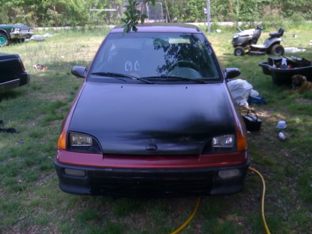

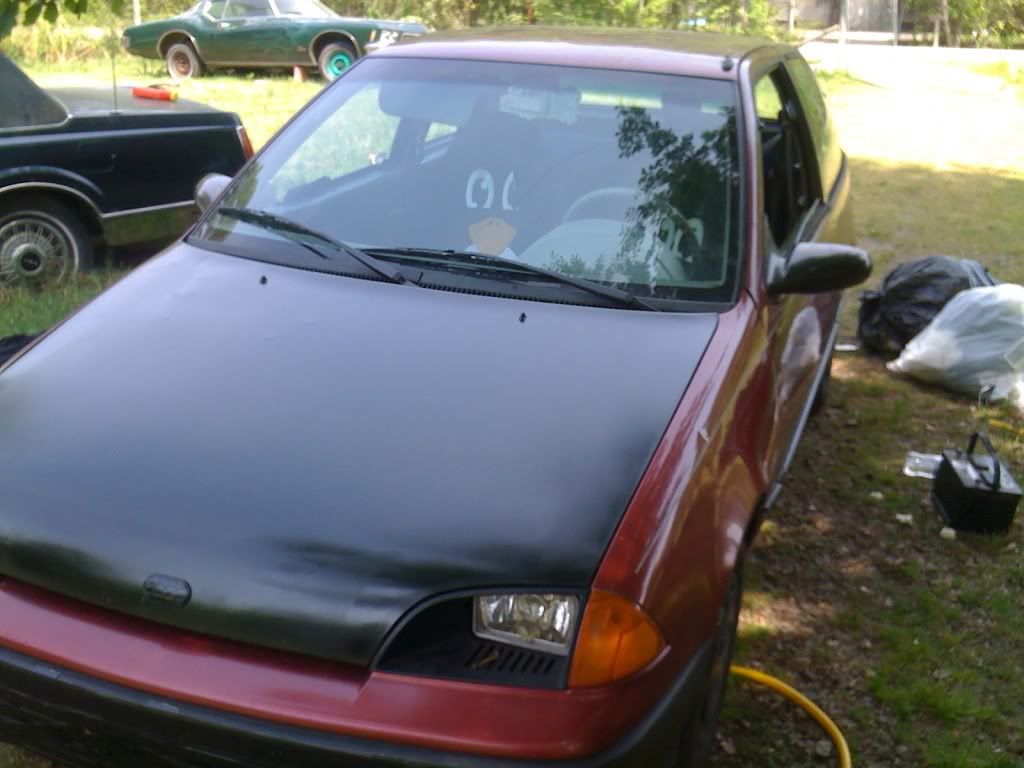

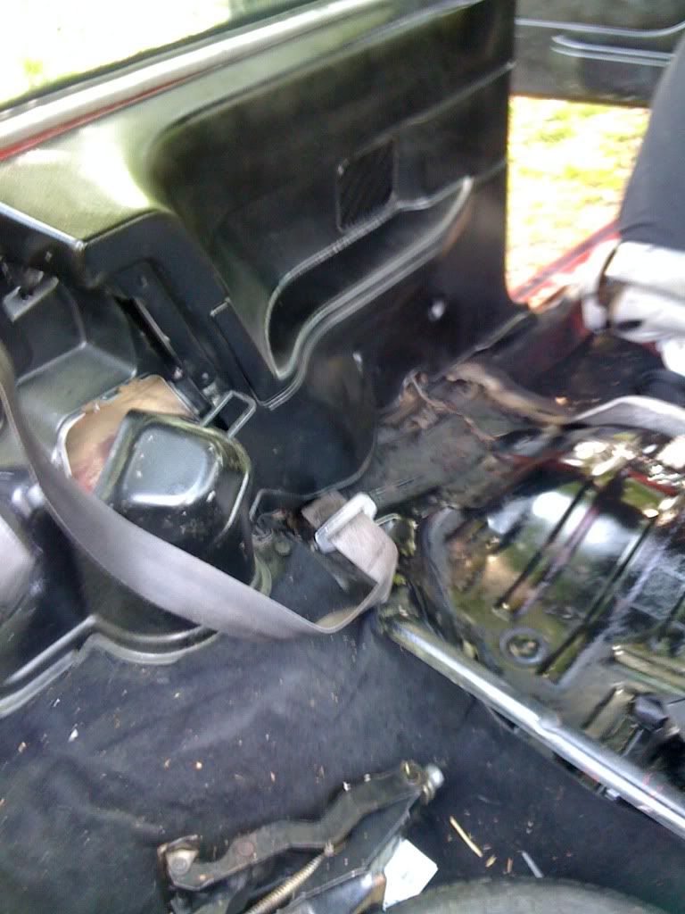

April 22nd 2010 update.
After painting the middle part of the steering wheel black I traced the "METRO" with a white paint pen. Picture Below.
Gas Fill Door Painted Black
Hood Painted Black

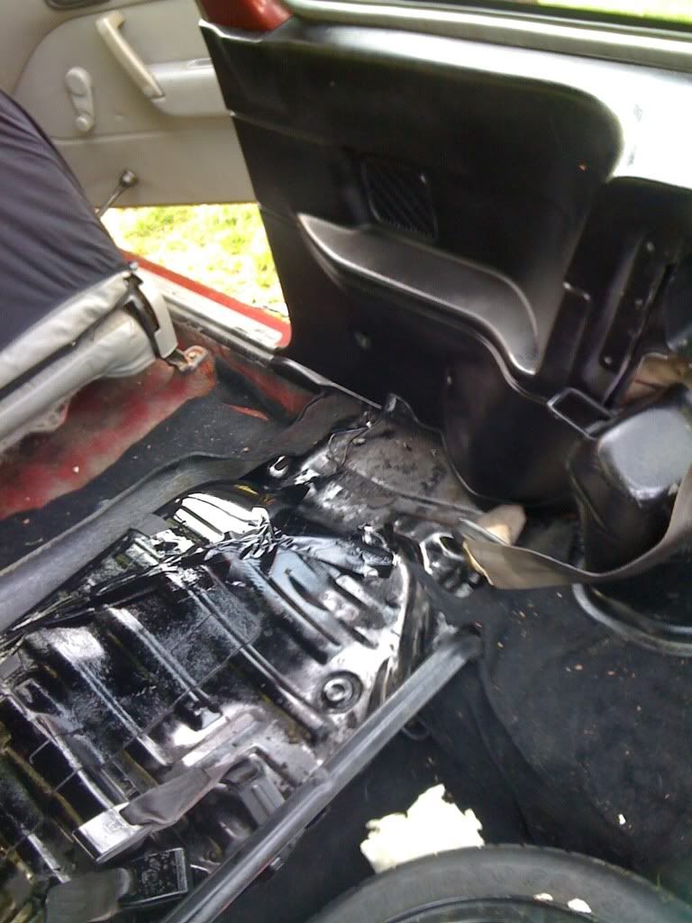

Whole car carpeted with Black carpet.

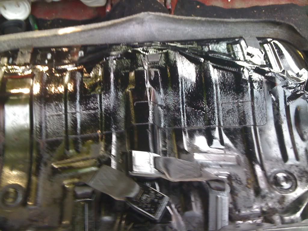

Pulled Rear seat out and painted underbelly with black paint to protect against rust.

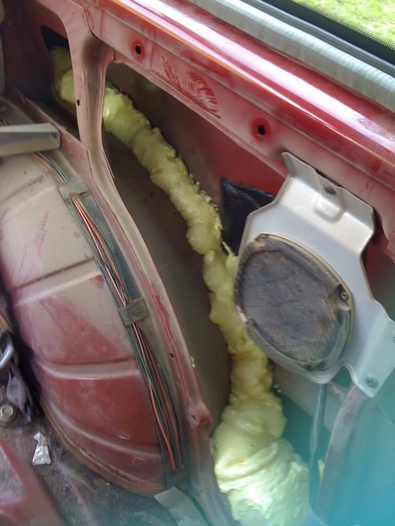

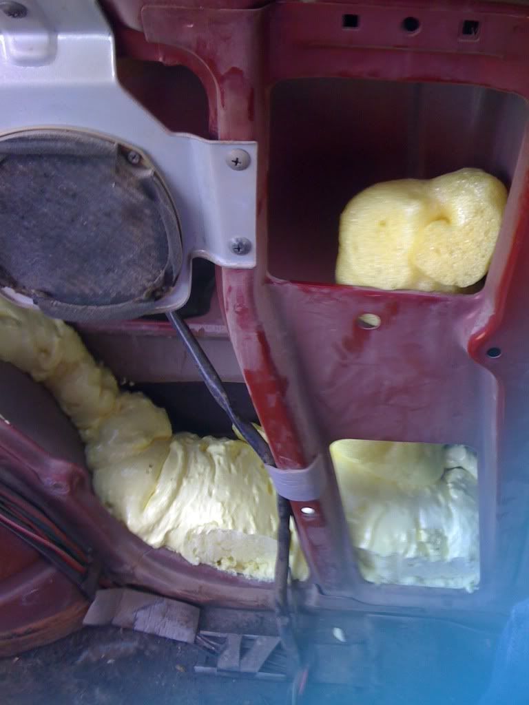

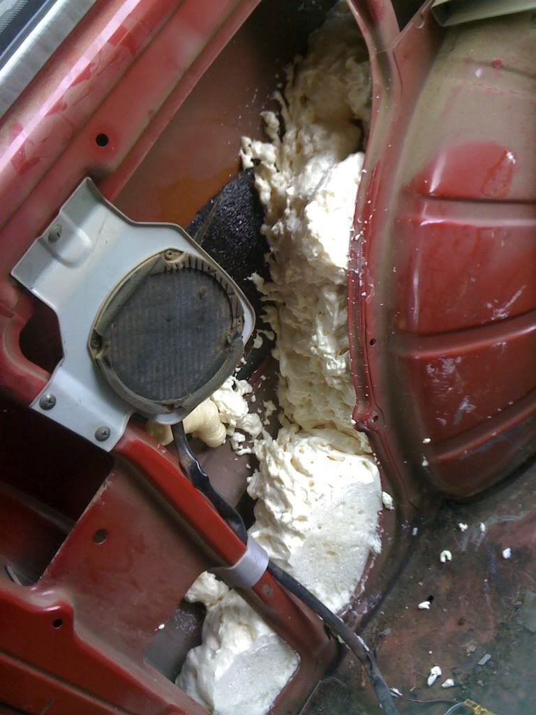

Filled sides with great stuff. Heres a quote from another posting.
"I used great stuff in the pockets on ither side of the rear seat. I also sprayed rustolinium anywhere there was rust or where I had cleaned up that gross car mold looking stuff. I tried 2 different kinds of Great Stuff. I tried window/door and outdoor. The window/door is much tighter and didnt fill in nearly as much, but the outdoor is very open and the foam isnt as thick. I cant really tell which is doing a better job, but if I had to guess it would be the window/door. After spraying it in I had it poof out of the pocket a bit. I took a razer blade and simply trimmed off the excess with one long cut.
Can I tell a difference?
Yes! There is no air wooshing back through the pocket and its much quieter. Though the air "leak" was small it was still enough that it kind of whistled. It couldnt have been more than a small pin hole or two though.
Pictures Below Enjoy:
Posted Image"
