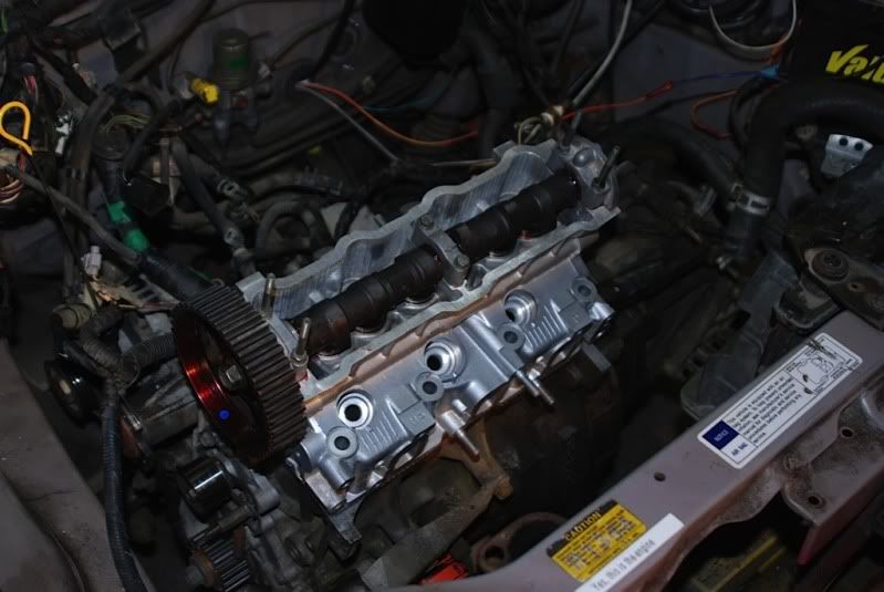

Well.. We finally got around to doing a semi-rebuild on the engine of our Metro racecar!!!! Plan to get some pics up in the next few weeks. Next race is mid-April at Gingerman raceway.
Need advice on optimizing HP without breaking the bank. Have started talking to 3tech and Maxbore.com. Just seeing if there is any other advice besides the typical +10 timing sprocket, enlarging TB to 42mm, head, and cam? Does anyone do anything with the exhaust mani? Ours is ruuuuusty! We may just buy a new one, but open to all suggestions. The engine had a complete rebuild 1500 miles ago and is in great condition otherwise.
Thanks guys!
TB bridge delete, porting, cam, cam gear, G13 clutch and flywheel

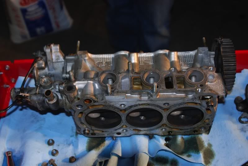

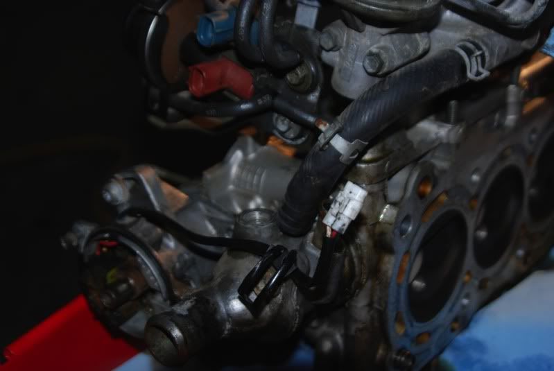

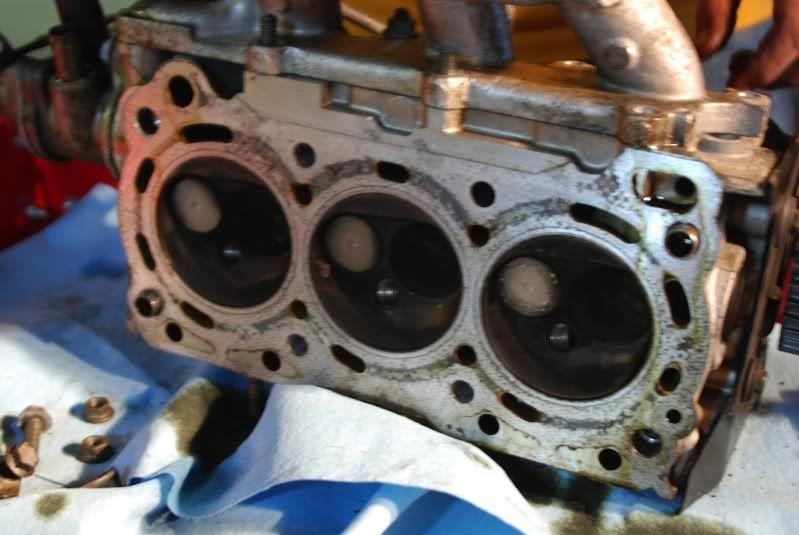

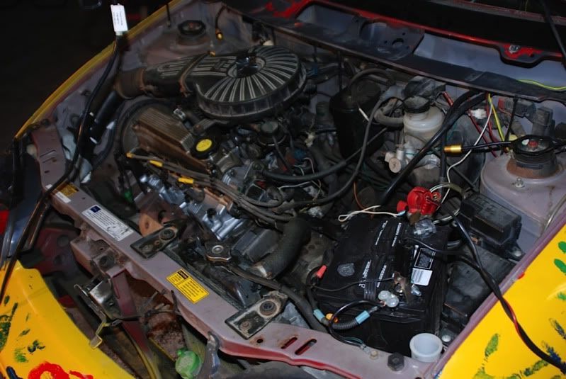

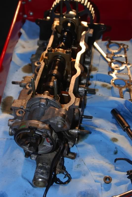

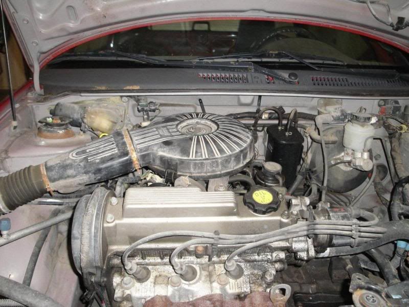

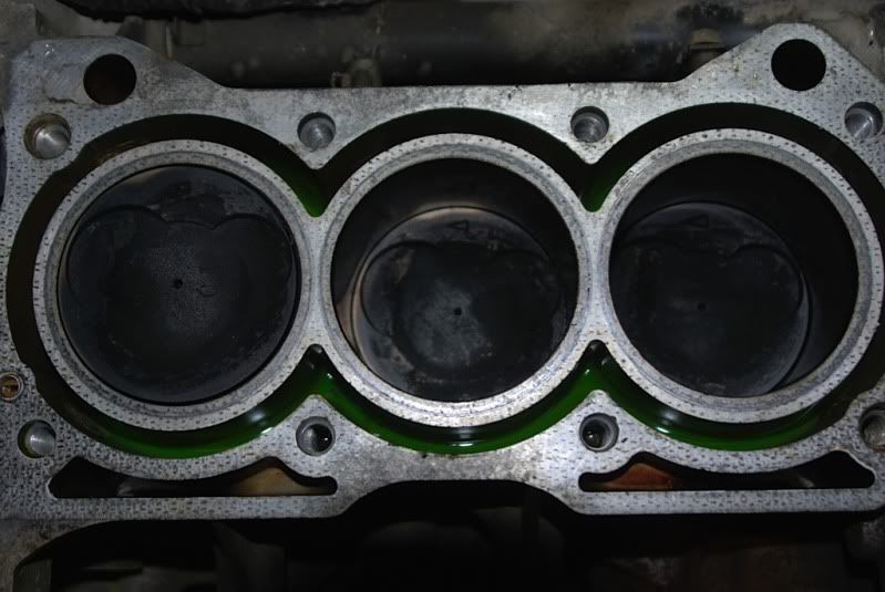

Well here's what we accomplished today...

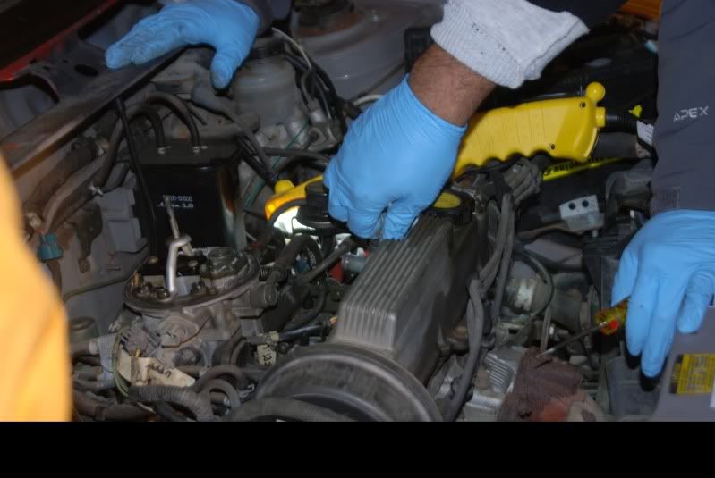

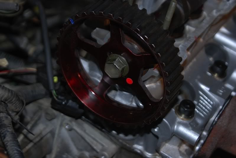

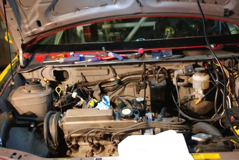

We started disassembly...

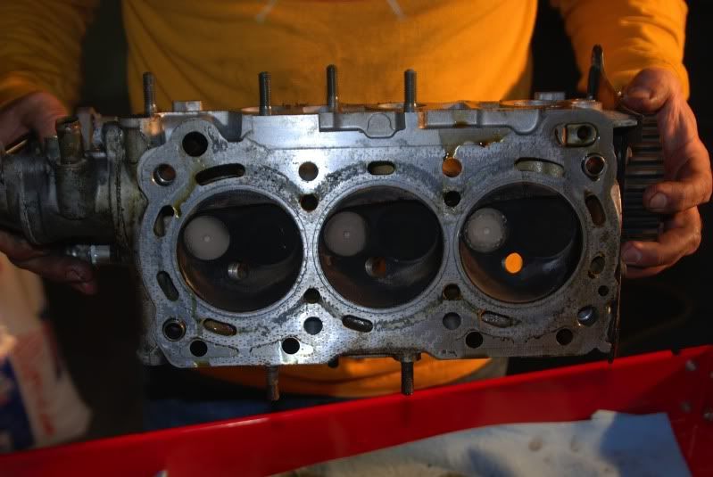

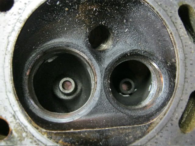

Pulled the head off...
Further dissassembly...

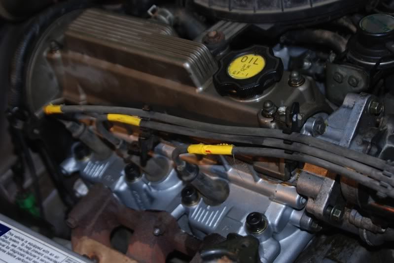

Other views of the head...
More to come!!!!!!!!!!!!!!!!!!!
DrDomer
Jan 29 2011, 09:22 PM
TB bridge delete... Got it.
Do people do anything to the intake mani to match up to the TB?
The rest we knew about engine-wise.
Not sure the clutch helps us much. We've found (because of our lack of power) that we're in 3rd gear 99% of the time on the track.
Where do we get the flywheel???
