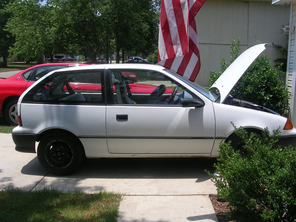

Got it set down like I thought it should. Still didn't change anything. I'm in the process of cutting the rear springs. 1 coil all the way around. |
| Coche Blanco | Apr 21 2010, 08:48 PM Post #63 |
![]() ![]() I didn't measure the before, because I didn't really feel like it. ![]() this is 1 coil in the front, and 3/4ish in the back. I would suggest 1/2 in the back, or 1-1/4 in the front with 1 in the back. I'll get better pics in the daylight, I just looked at how blurry those are. Edited by Coche Blanco, Apr 21 2010, 08:57 PM.

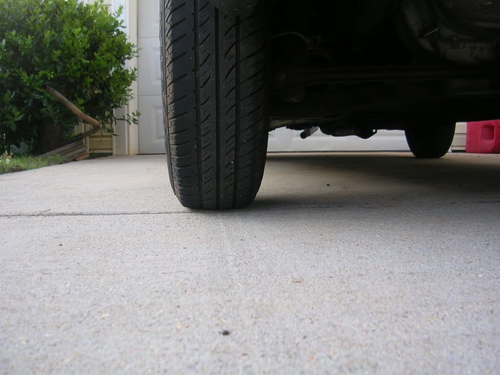

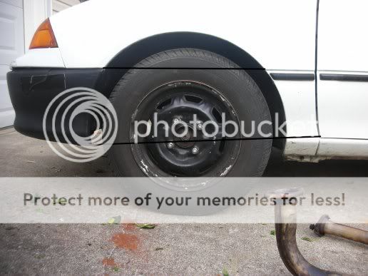

Looks like one side is higher than the other, not sure what's going on, but I can't do anything about it. I cut them the same length, but it's just not sitting right.![]() ![]() ![]() ![]() |
| Bad Bent | Apr 22 2010, 11:53 PM Post #66 |

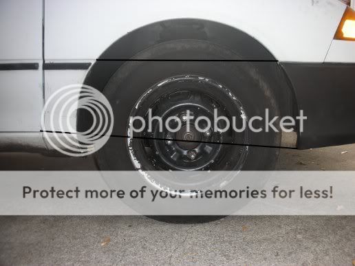

I believe you may be wrong. I used your pictures and held a straight edge up to my screen at the same points. Select the same points on your car, like the bottom corner of the bumper and the corner of the door and the body creases that align with the middle of the tire sidewall. They look really close to me. You can do the same thing with a piece of string.![]()

hey coch, drive your car around. when i cut my springs it looked like the body was lower on the left. After about a week it seemed to level out and it looks good now. I think everything had to just settle in. O and look at your brake pad, is it making full contact with the rotor? From the inside to the outside of the pad? sometimes they make rotors where not all of the surface is used by the brake pad. Edited by obaja, Apr 23 2010, 12:14 AM.
| bogs | Apr 23 2010, 01:39 AM Post #68 |
Well, as BB suggests, it looks right in the pictures, but if you want to make damn double sure, get some construction paper/cardboard and make a template of the two wheel wells on one side. Make sure you car is on (as) flat a ground as possible, no bumps / rises / etc as that will throw off measurements. Then just use the template as a gauge. If your +/- 1/16, I doubt you would notice it riding around, but of course closer always = better. Now, if you find yourself off by > 1/16" you can always get some thin metal shims and make up the difference. don't go crazy trying to be too anal. Good luck
| Coche Blanco | Apr 24 2010, 09:11 AM Post #69 |
Yeah, I think it's settling out. Now to move on to the exhaust, i'm thinking about running a cherry bomb right after the cat, or possibly put the resonator and a few feet of pipe. |
