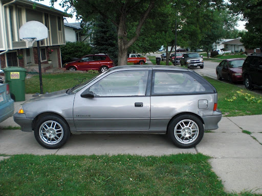

Hey Nate, welcome to the forum! I also have an '89 Metro LSi that I'm working on! Here's a picture of it in it's prime:
Don't let it's glossy looks fool you, it doesn't look nearly this good. The sun must have been hitting it just right I guess...

That looks pretty good for an '89! If nothing else, at least we can say we have the "original" Metros.
I noticed you bumpers are body colored, so are mine. Is that an Lsi thing or does that just mean our cars have been repainted and they shot over the original black plastic?

I'm pretty sure I read that the LSi model had the bumpers painted the same color as the body. It looks "sportier", apparently.

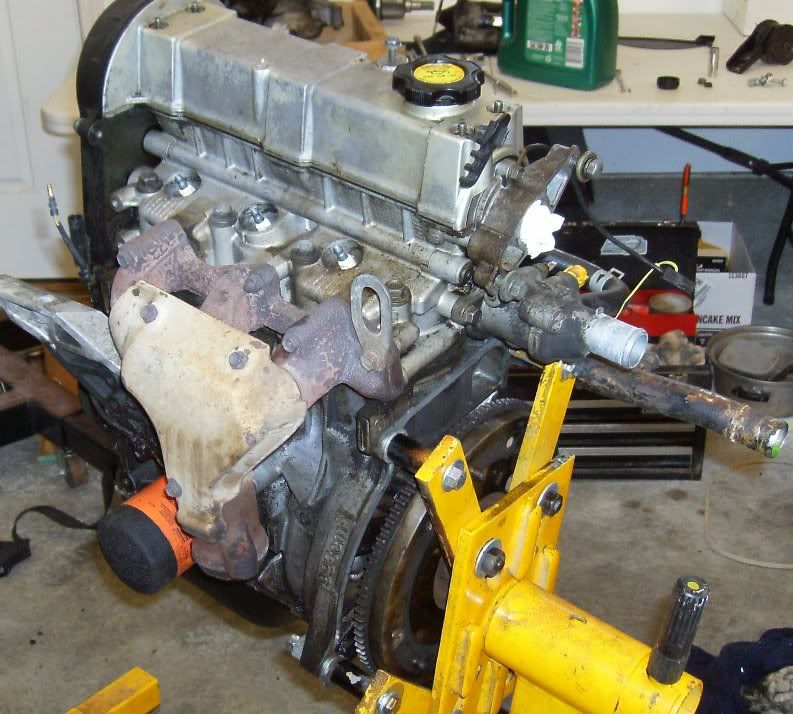

Well this started out simple enough and then I just kept getting deeper and deeper into the car until I eventually just decided to pull the engine/transmission out so I would have easy access to fix everything I wanted to fix.
The Heart of The Beast: I'm sure glad a friend of mine owns a cherry picker and engine stand and was kind enough to loan them to me!

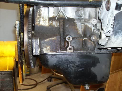

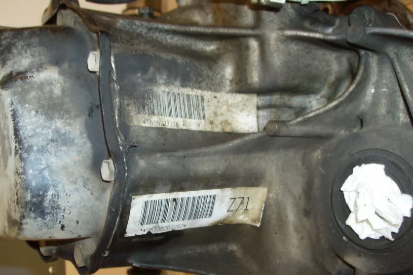

One nasty 5 speed transmission. The passenger side CV output seal looks to have been leaking for many miles. Once that oil hits the spinning axle and migrates to the flywheel it just goes everywhere!
Are these bar code labels on the transmission normal or might this be a clue that it isn't original?

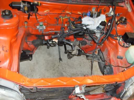

Since I have such open access now I think I will take the time to inspect the steering system for damage and worn parts.

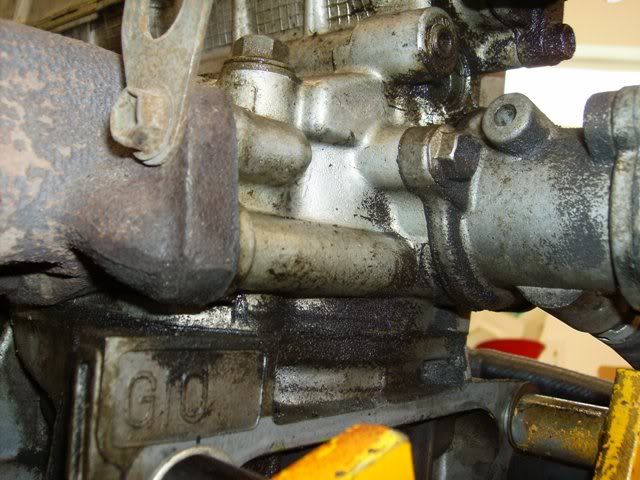

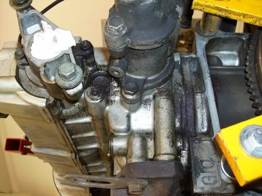

Lots of oil leaking from around the base of the distributor. Is that O-ring the only thing that seals that end of the cam/distributor drive :hmm If so I can see why I had the leak, that O-ring doesn't look very good.

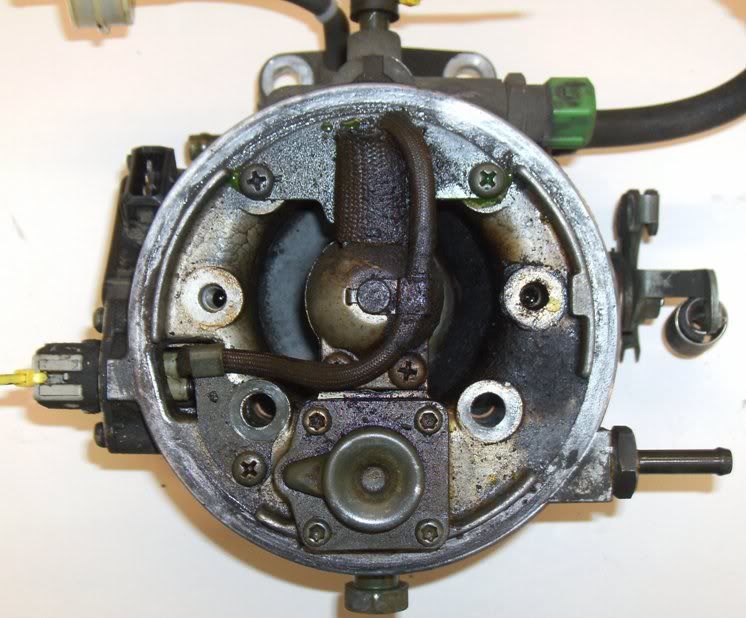

Nasty throttle body due to a plugged or malfunctioning PCV/Gas filter "T" pipe situation. Unless it is normal to see this much carbon and crud on the throttle body, but it sure doesn't look normal to me. The big question here is what can I use to safely clean this thing without risking any damage to the electronics? Also, the little fabric cover over the wires going into the injector looks torn but maybe this is how they all are (larger diameter cover over the rear of the injector is separate from smaller diameter cover over injector wires)??

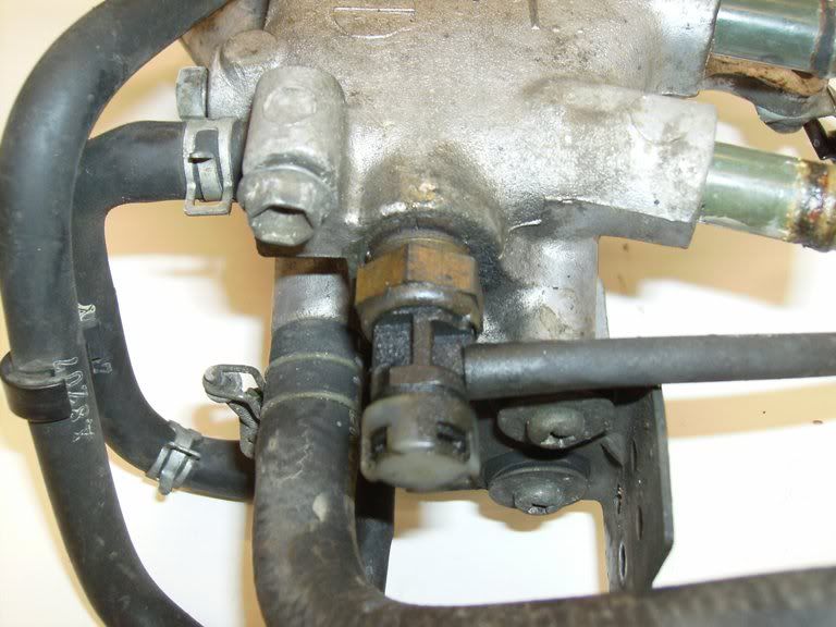

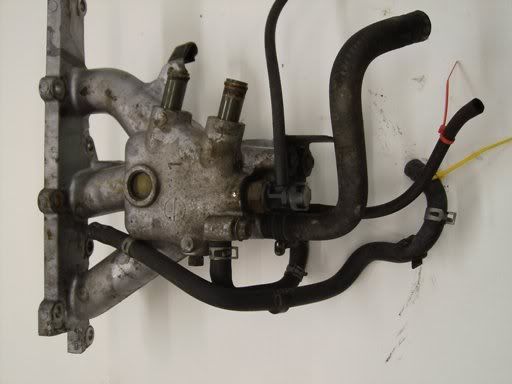

What is the thing on the bottom rear of the intake manifold? Next picture shows it better:
Leaking distributor drive O-ring makes it look like I have a leaking head gasket. My compression on all 3 cylinders was 190 dry and 210 with oil so I'm assuming my head gasket has to be in good shape?? Is it possible to get that high of compression with a bad head gasket :hmm
Another view of head gasket area on distributor side.
That leaking CV output seal sure made a mess of everything! The trans only had 1.25 quarts in it when I drained it :shake I wonder what sort of internal damage has been done to the transmission from however many miles it was driven with low oil.

You found the dreaded distributor o-ring. Easy to fix, eh. ^o)
According to my '91's hood sticker that is the BVSV - Bimetal Vacuum Switching Valve. That's all I'm good for tonight, er, ah, this morning. B-)
metroschultz
Yes, By-Metal Vacuum Switching Valve.
Opens when warm.
It is there to prevent the car from drawing the stored gas fumed from the canister until the car warms up.
The extra fuel, those fumes provide, would make it hard to control the mixture during warm up (closed loop)
The computer uses a predetermined set of maps for closed loop, and that would richen the mixture with no adjustment available.

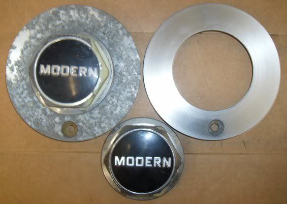

I had to put the Metro project on hold for a few weeks and get back to making some money when I'm out in the shop instead of spending all my time tinkering on the Geo :shake
While I was in machining mode I decided to fix my wheel centers. The centers must be made of some really low quality aluminum because they were in terrible shape compared to the wheels.
So I popped out the plastic center cap and threw the aluminum rings on the lathe. After I matched the angle they cleaned up pretty nice. Now I just need to run an end mill down inside the mounting screw pocket to clean those up. Then I can wire brush the rest of the "chrome" off the plastic center piece and maybe just paint those black.
Before and after
Edited by Nate, Apr 28 2010, 10:28 PM.
Jittney
Nate,
Very nice results with the lathe....I thought I was looking at a new part, until I read the print. :drool
