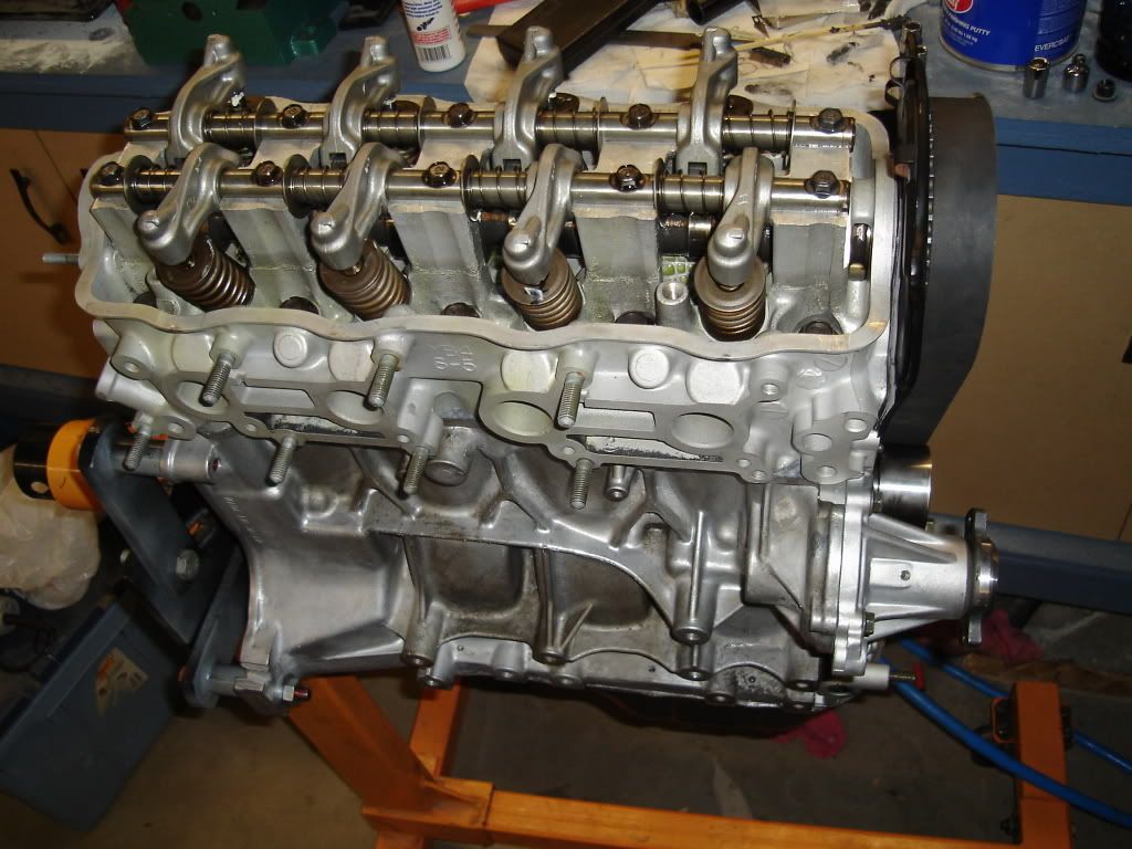

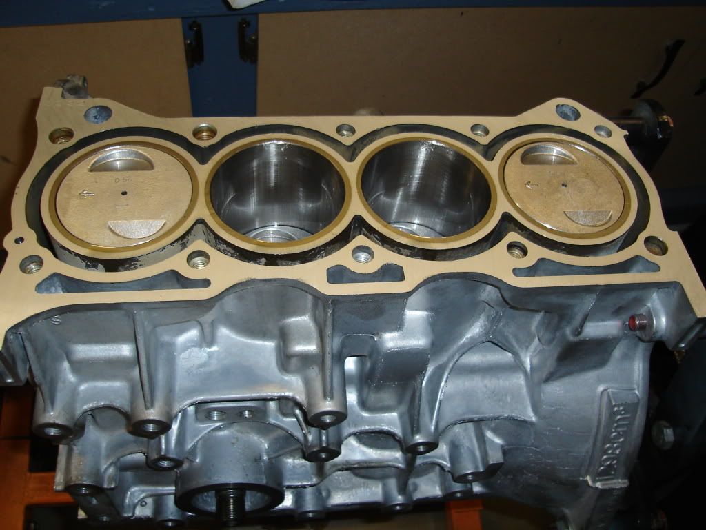

| Bill CNC | May 31 2010, 03:42 PM Post #14 |
Naw, ... they just want to see engine porn, so let me be the first to post some, ... Rebuild it and it will be all shinny and new! ![]()
