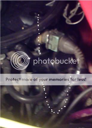

i took a break to think and went back over our posts and i forgot bout tha engine codes. put n a fuse and the check engine light flashed twice then three times i understand 23 and is for iat sensor? what is this and is this my problem? |
| StevieC | Jun 11 2010, 01:16 PM Post #50 |
Intake air temperature. Attached to the rear side of the intake I believe... maybe the wires are disconnected? Temperature of air affects fuel mixture so yes it could be causing your problem. Check that it's connected!
| Bad Bent | Jun 11 2010, 01:47 PM Post #51 |
IAT is the blue/green square connector in this picture. In the air cleaner it's the brass thingy.

ill chk the iat connection. Just had filter holder off and egr off and cleaned. could that set off this code. ill let it run awhile then chk again. Not done a comp test yet. is better to check thru plug holes or off radiator?? and my water pump seal leaking and goin bad will this throw off the radiator test? |

Did you set the timing after the new dist. install? You kind of have to mess up the timing to do a dist. swap. If the timing is way off it can cause the symptoms you speak of. The code you got was probably due to the plug not being "snaped in" You have to give it a good push and will hear a click when it locks in. Clear the code by disconnecting the battery for 1/2 and hour, and then put it back and see if the code comes back. Edited by crankcase, Jun 11 2010, 08:19 PM.
| djdiamond | Jun 11 2010, 09:27 PM Post #60 |
yeah the new dist was in place when i checked timing. I checked tdc and rotor button alignment as well. i pulled plugg out and cleaned out a lil to assure good connection. Ill reset and c. |
