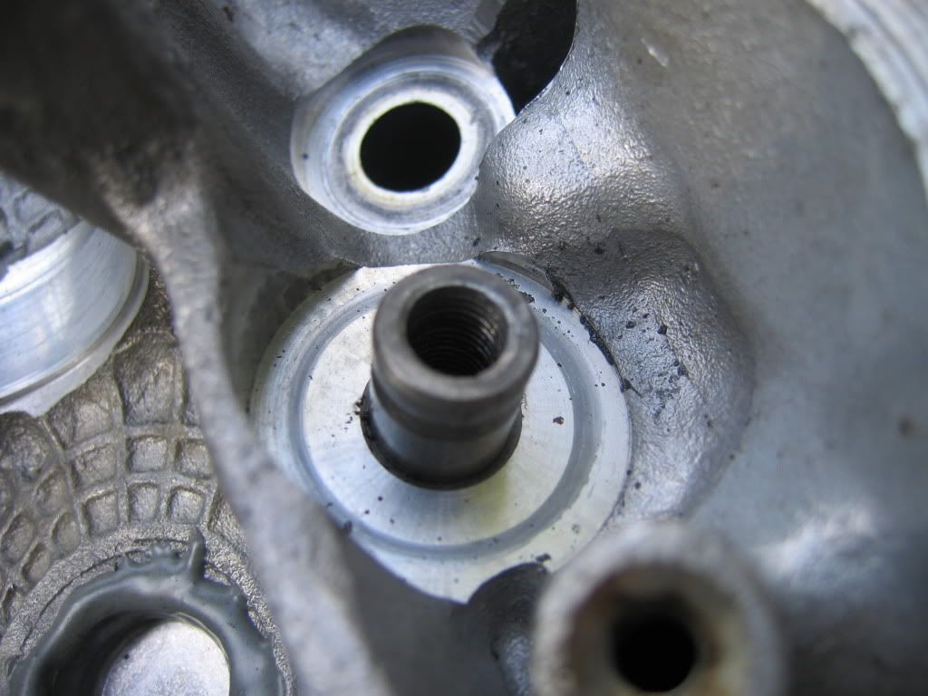

Hey Fellers Been a while since I posted but I got my block and head from the machine shop today. (FINALLY!) Had them flattened, bored, cleaned, and a valve job on the top end. I was under the impression that a valve job involved cleaning, lapping new valve guides and seals. Before I take the head back to them I wanted to get your opinion on what I've got going on here. It appears they have replaced only the intake guides and not the exhaust side. Not only are there hairline cracks on the guides (the ones not replaced) but it looks like they have been threaded also!? This can't be right. I've spent a lot of money on this step of the rebuild and was wondering what you guys would expect from a machine shop after 500 bucks in mostly labor. The only parts they ordered were 4 valve guides. The photo is typical of all four guides. The cracks didn't show up in the photo. The new guides are smooth and purdy. ![]() Haven't looked at the block yet, its bored 50 over. Anything in particular I should look for while inspect the block ? P.S. I will do a project thread when the assembly begins. I got pistons and rings from partsdinosaur.com and will be ordering all the gaskets and seals from there also. If not for this forum I'm not sure I would have taken on this project, I appreciate the help ya'll have given me. |

I forget the name of the repair, but there's a method where the metal in the guide is displaced, then reamed to size. Overall there's less metal but the I.D. is corrected. I've never seen one in person but that's what I think it would look like. What's the JB weld looking stuff to the left? (looks like it's a freeze plug they used it on) Edited by JellyBeanDriver, Jun 2 2010, 09:01 PM.

JellyBeanDriver's got it, it's called "knurling." Kind of a cheap fix that's an alternative to replacing the guide. It seems odd that they'd even bother knurling when they replaced the intake side. Why not just replace them all? BTW, a valve job should include refacing the seats with a cutter or stone (not lapping), refacing the valves (or replace if needed), guides checked and replaced as needed (or knurled), new valve seals, head checked for straightness, and of course cleaned. Edited by Rooy, Jun 2 2010, 09:41 PM.

Thanks for the reply's It seems that all the freeze plugs on top have that goop on them. I don't know why all the guides were not replaced I don't want to them more money so hopefully the knurling will be ok. The valves and seats were refaced. I am however missing all but one of the alignment sleeves. No seals were replaced, just removed and tossed. Are the alignment sleeves (for lack of correct terminology) easy to find? I may need one for the motor/tranny also, can't seem to find all of those either. |

Tech Certified
That goop is just a sealant they use on freeze plugs. I use it myself, but not THAT much. Just a light film is enough. And for 500, I would expect much, much more. New guides, valve seats resurfaced, new valves set and lapped, the whole works including assembly. |
