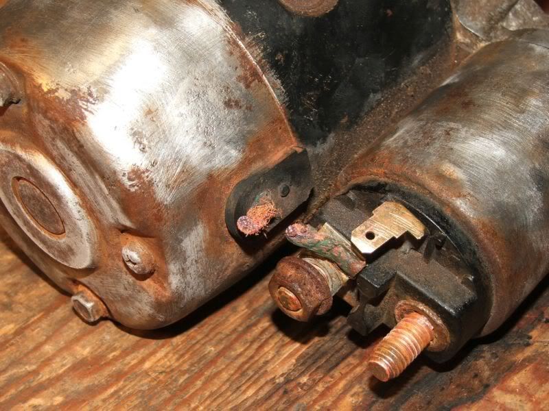

So, the metal pin here is where I plug the small wire giving me problems:

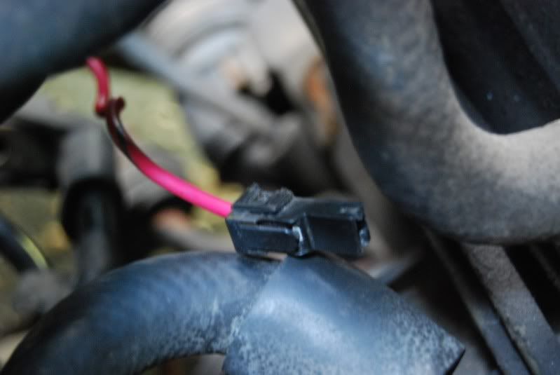

Now on this one, I am guessing the small wire is the black one going to the starter:
Now.. what is that blue wire? It has nothing to do with the starter, correct? 'cause it's definitely not on mine...
On my car, the small wire is small. The black plastic around it is also broken half way and the wire looks damaged. Also, the piece that slides on the metal pin on the solenoid is like a small plastic head. I can't crimple it. I could however cut the head off and perhaps tie the wire directly to the starter but that's a bit iffy...

Dark Blitz I think you have a veery simple problem. All your assumptions above are correct. The blue connector is not part of the starter wires.
The damaged wire is a question, but as long as the copper is not cut, you should be fine. A little electrical tape can take care of any damaged sections of the insulation.
Try crimping the connecter through the plastic. Take a set on pliers and try to give it a squeeze. I think once this connector is tightened up a bit your trouble may well be gone. If you break the plastic, it is not a big deal, At the very worst you would just need to get a new connector crimped on. You can buy the stuff to do it yourself for about the cost of a fast food meal.
Please be sure to try tightening up the connecter before you spend more money or do more trouble shooting, this is especially true if it feels loose.

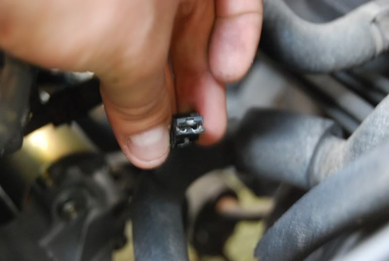

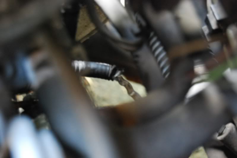

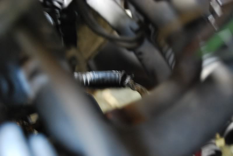

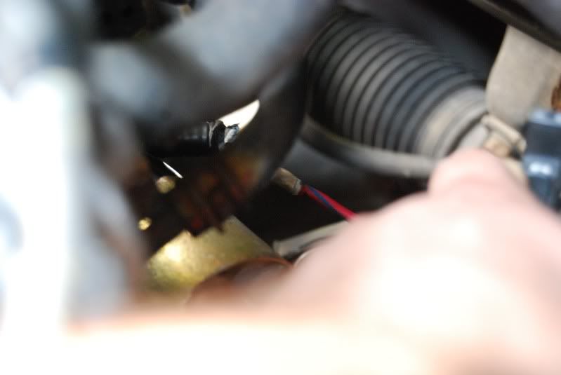

Here are pics of the culprit:
and now the part where the wire looks weird: (it's a bit hazy but couldn't take much better pics)
Thanks to all for the help!

The bottom 2 pictures in post 18 show a wire that has been overheated.
It has semi melted insulation.
This wire needs to be replaced as far back into the harness as the burn goes.
You may be experiencing voltage loss through resistance of the burnt wiring.
When replacing the wiring, solder new wire in to replace the burnt stuff.
Then use a good quality connector on the business end.
Let us know if that helps.
