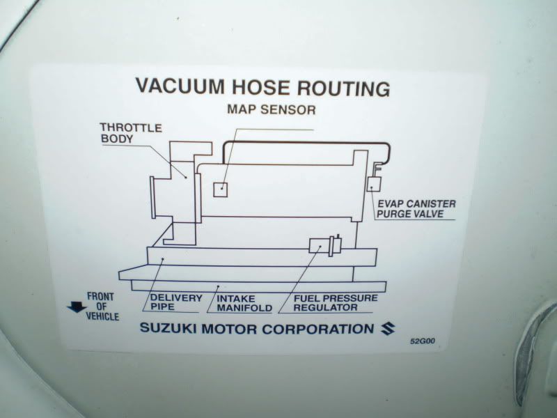

I think I made it pretty clear that the newer engines are MORE reliable than the older ones. Ever heard the one about the guy that had the EGR system failure (ok... several guys), that doesn't happen in a car that's missing an EGR. The failure prone problems of the earlier engines had been addressed with the 98+ 1.3 engine. Complaints of the hose going to the MAP sensor failing and causing driveability problems was solved by mounting the MAP sensor directly to the intake manifold. Have you seen the vacuum hose routing diagram in the newer models?
For comparison, here is an early model:
There are less failure points in the newer engine than in the older one. It's hard to find a distributor leak when you don't have a distributor. (99 and up)
