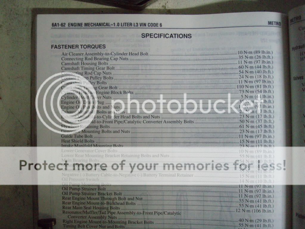

I am in the reassembly stage of a rebuild on a 92 1.0 and just experienced a very strange thing. I put the main bearing caps on and torqued them into position, installed the pistons (one at a time) put the bearing cap on each and tightend them just snug going back when I had all 3 in place and torquing them to the FSM 40 ft/lbs. #3 worked just fine, #2 seemed odd so I stopped after a bit and went on to #1 which never seemed to come up to the appropriate torque. Eventually I snapped off one of the #1 bolts and visually #2 were over tight. I then took the torque wrench and checked it against the main bearing cap again getting a audible click at 40 ft/lbs. I will be replacing the bolts on #1 and #2 but am wondering what I may have done wrong. Ideas?
bennie442
Rod bearing caps are 26 lb.ft. in my factory service manual. Main crank caps 40 lb.ft. Therein lies your problem.

Looks like they have a spec for connecting rod cap nuts and connecting rod bearing cap nuts. What's the difference? I'd like to know myself!

Also In my '91 Sprint/FIrefly FSM there is only a spec for "Connecting rod bearing cap nut 26 lb.ft."

Engine bottom end is back together. 26 ft/lbs worked MUCH better. Nearly had the top end together but managed to propel a valve keeper across the garage and am simply too tired to contine the search tonight. Hopefully she lives tomorrow.
