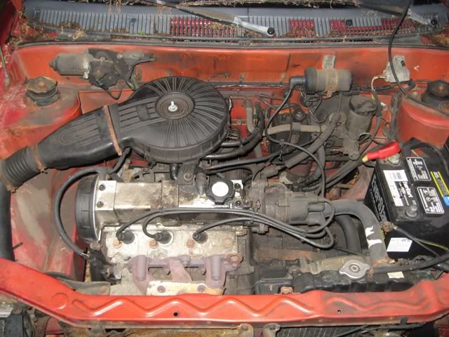

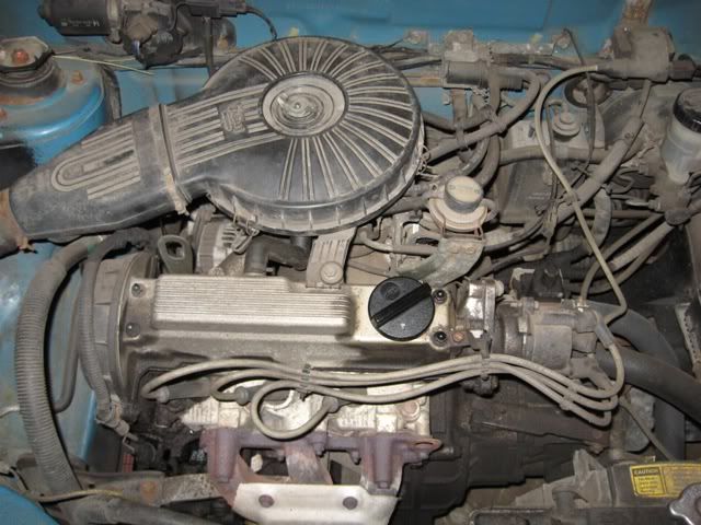

Next week begins phase one of my Geo project.
Plan is to swap this 91 G10
into my wife 93
I have reason to believe that if I swap the intakes & distributor, this should be pretty much a plug and play deal.
I hope to pull the 91 this coming Monday. Then clean it up, replace the clutch, tranny seals, timing belt, water pump, cam & crank seals, though out the week. Then Saturday & Sunday do the swap.
Can you think of any hidden surprises?

Parts should be here before the weekend. Rear seals too. I did plan on augering out the egr. I may have to swap the valve covers too. Looks like the routing changed a little. Thanks for the encouragement.
