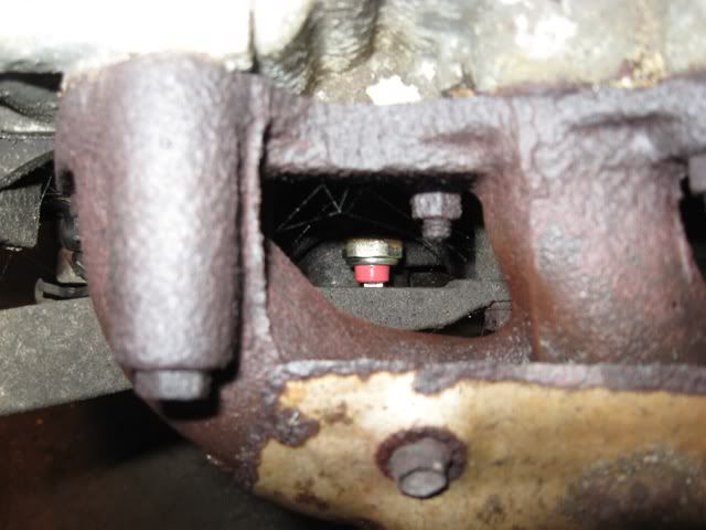

anybody got a pic of the sender unit and where it's located?
I had a picture on some thread but cannot locate it now, that is if my 95 is the same as your model. Mine is a guage though. It should not be hard to find, look for a one wire sensor which is usually small. Do you have a guage as well or just the light?

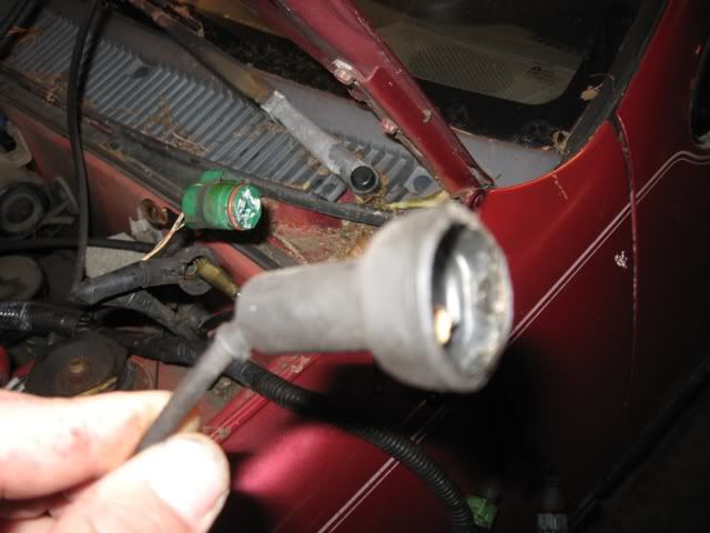

There's a pretty good shot in the how to pull a G10 thread. It's down by the oil filter covered with a big rubber boot. Simple spade connector is under the boot. You can see it, from top, looking between the exhaust manifold. I just had my hands on it. My donor car is now peeled down ready to pull the output shafts, unhook the mounts, and lift the engine out as of tonight. (project thread coming shortly)

The oil pressure switch (or sending unit) closes at 4.5psi or less, and is located above and to the right of the oil filter.
Took this before coming to work for the location of the sender
Here the plug
