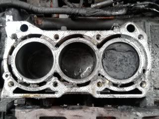

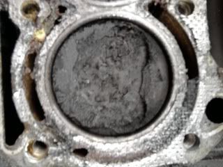

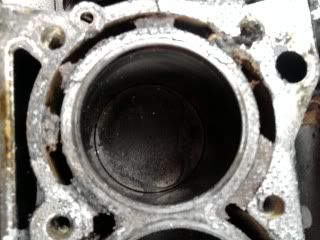

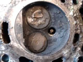

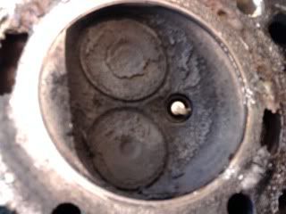

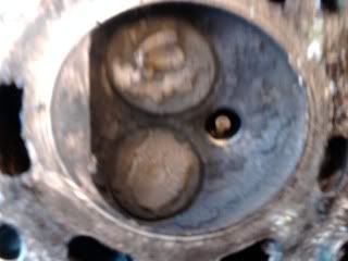

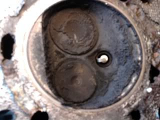

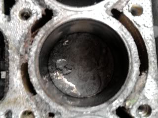

well i finally got the head off , and i don't think I've ever seen such bad carbon deposits. the head gasket is so badly worn and falling apart it's falling into the coolant jackets, what do you guys think i should do? also how do i remove the stuck on pieces of gasket off the block and cylinder head? Thanks guys!![]() ![]() ![]() ![]() ![]() ![]() ![]() ![]() Edited by HavsCritiria, Jun 27 2010, 06:53 PM.
| Coche Blanco | Jun 27 2010, 06:57 PM Post #12 |
Holy hell! |
| HavsCritiria | Jun 27 2010, 07:00 PM Post #13 |
our reactions were similar. |
| Coche Blanco | Jun 27 2010, 07:03 PM Post #14 |
Did you do a compression test before you pulled it? |
| HavsCritiria | Jun 27 2010, 07:12 PM Post #15 |
nope it was billowing white smoke when i got it so i just decided to pull the head off right away. Probably should'a done one now thinking about it. |
