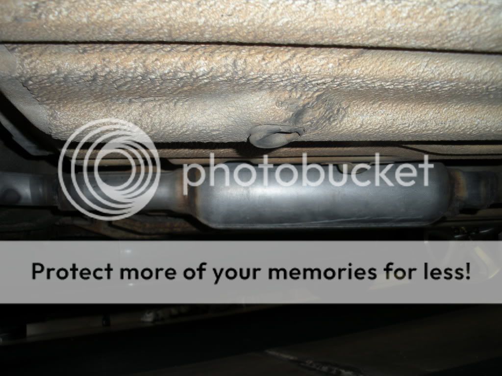

![]() I am pointing to a bracket that was hanging of the undercarriage and do not know what it was there for. It appears to have been cut with a torch. Is this the hanger for the rear muffler? Dave |
| progolfwife | Jul 12 2010, 12:23 PM Post #6 |
![]() ![]() Here is the rest of the system. Dave |
| bogs | Jul 12 2010, 07:37 PM Post #7 |
That looks right (hard to tell though) the part that passes between the swing arm and the frame is just the pipe, the muffler attaches past that point in that well towards the rear. |
| mcmancuso | Jul 12 2010, 07:40 PM Post #8 |
that bracket is the one I took my picture of, mine has the rubber piece attached instead of that metal strap piece under the bolt. Its the outer mount point for the muffler. |
