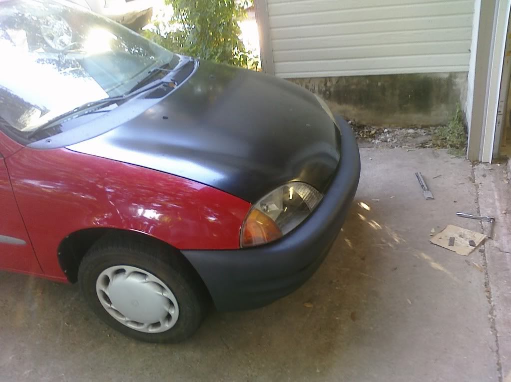

I've been looking for a 4-cylinder 5-speed 95+ Hatchback with AC for last couple of months and I ended up picking this beauty up last week for $600. As you can see it was in a little front end accident, it's a 2000 with 130k on it. I had to buy a set of airbags, bumper cover, bumper support, radiator, headlights and hood. Got everything for about $400. so the tally so far is sitting at right about $1000. Not a smoking deal but not bad for exactly what I wanted. I already have the new hood on, fixed the mounting brackets for the bumper support, mounted the new air bags and also threw in a gauge cluster with a tach while I was at it. The car runs a drives great! I drove it home, no pulling or jerking. I plan on ordering a scan gauge once it is all done to help get a little bit better gas mileage, probably do a few of the aero "tricks" as well. I'd really like to hit 50mpg with the car. Not sure if that's realistic or not but I'll try. This forum has already been a great learning tool so far.

Thanks guys, I got the front end squared away. I actually got all the lines pretty straight too! I plan on leaving the hood primer, aesthetics aren't that much of a concern on this car. Little bad news though, the headgasket may be toast. It's smoking a little bit at idle and when I start it up. The smoke doesn't smell of oil at all and the radiator did have a small hole in it from the accident so I'm pretty sure it's been overheated bummer![]()

Worked on the car again today. It's earned itself a new nick name Project "Rat Swift" Because of the black wheels and hood. One of my co-workers called it the Rat Swift and it's stuck. Today I replaced the front control arm since I thought the ball joint was bad. I jacked the car up and took the wheel off and could see the ball joint shifting as I rocked the wheel. Well it turns out it wasn't the ball joint. The CV joint has been replaced recently and the hack mechanic stripped the bolt that threads thru the ball joint and had the nerve to just leave it stripped. It was s simple fix, all we did was put a longer m10 bolt in with a nut on the back. I ended up putting the new control and ball joint on for the hell of it. At any rate no more loud knocking from the front end!! Next up is probably a front air dam, passenger side mirror removal with custom cover plate, maybe some weight reduction, still need a radio of some kind also timing belt soon but since this is a non-interference motor I'm not too worried. I took a few better pictures with a actual camera this time. |
