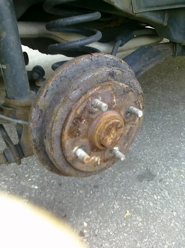

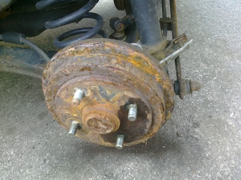

Thanks for the replies, guys. I will be working on the body sometimes but at the moment I'm more concerned about my wheel. Take a look: Left RightThe left wheel does not spin freely. It is rough and probably needs lubrication. This is probably what would kill MPG. I'm not sure of the correct naming for this: wheel bearing? Anyone know how to fix this up? And is the rust for the wheel bearings normal? |

The big rusty thing you're looking at is the drum. Wheel bearings are a few inches in diameter and pressed into the center of the drum from the inside. It could be a bad bearing, it could also be the brake shoes hanging up. Does it just feel rough but spin freely, or is it hard to turn, like the brake shoe isn't fully released? |

When you spin it, it still does spin but not as smoothly as before. It feels like it's gotten drier/rougher (similar feeling to losing lubrication). It isn't difficult to turn. And these are rear wheels, not front wheels. There aren't any brake shoes (right?). |

If the bearing has gone bad usually there will be some play. Grab the drum at 12 and 6 and push/pull and carefully feel for any movement. This might be easier if you bolt the wheel back on. You have drums in the rear. Drum brakes use brake shoes. Front has discs and brake pads. |
