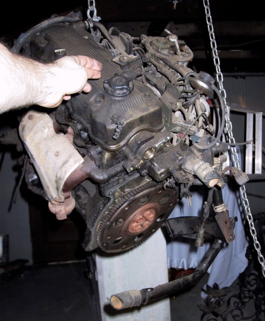

Next step, verify its the right thing and not missing major parts. Does it look right?
Posted Image Posted Image Posted Image Posted Image
If everything's a go, there's at least two weeks to prep. Will clean it up, take the bad stuff off, etc.
Guess the recently purchased exhaust manifold gasket should be returned!
Well, I'm glad you did not pay $700 for the engine. :thumb :thumb
That's like $400 and shipping which is acceptable, eh.

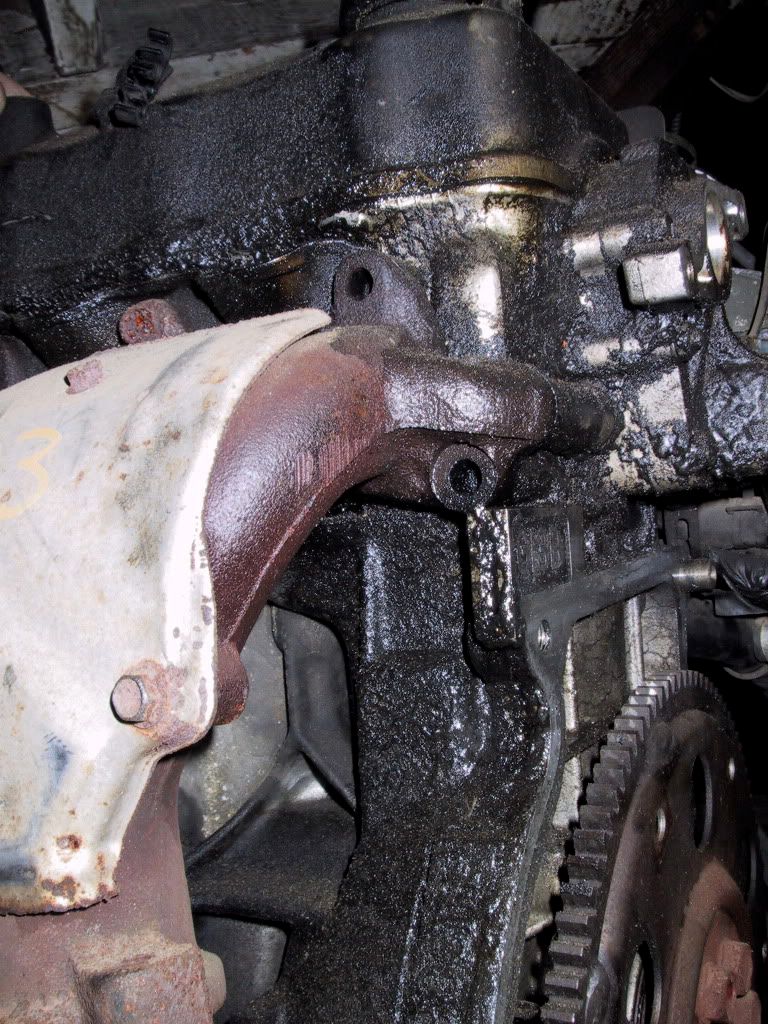

I suspect the distributor was broken in transit., looks like they did you a TB bridge delete "favor." :ermm: The EGR modulator is off so that's why I suspect the distributor was broken off and removed, besides the mount surface looks way to clean compared to the rest of the engine.
I'm glad you have the time to give it the love and care I know you will. ^o) :coffee
I'm no good with year/models/engines.
95, 96, 97 are all the same engine. Sensors and controls may vary though, so you're better off using the entire intake manifold and distributor from your original engine.

if you are intending to run that motor as is you will of course find out where all the oil is coming from. i know you want to do it on the cheap but now is the best and cheapest time to tear it down. did you buy a running motor or a rebuildable core? from the appearance its a core, just to much oil every where. at least do a compression test on the floor before you install. that motor does not give me a warm and fuzzy feeling

• The fourth bolt along the top of exhaust manifold is clearly missing, is there one below it also missing? It's gone on Gary so don't know if it should be there. Given at least one's been gone, should the manifold gasket be replaced before tightening it back up?

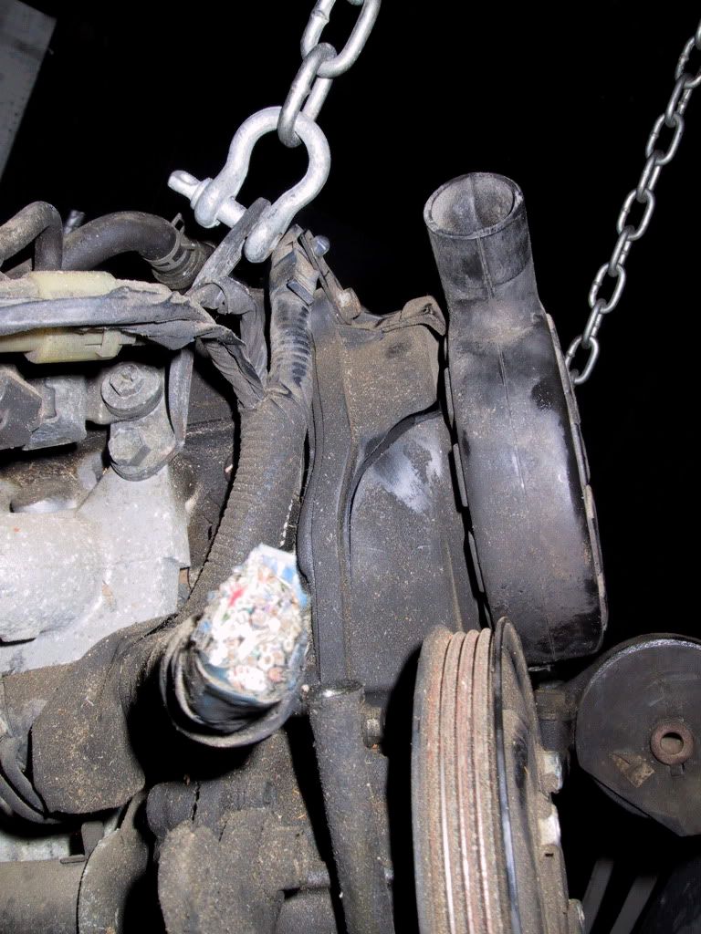

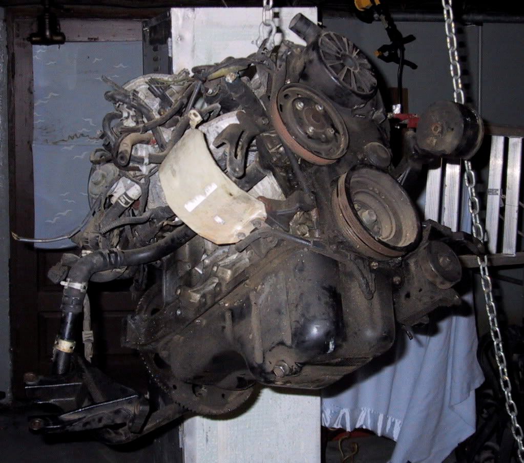

• Here are a couple more pix of engine (hanging like a side of beef). Should I just punt on this one given issues and oil leaks, or at least take it to compression check? Thanks again!
Spock
Live Long and Prosper.
At the very least I'd say do a compression test. If I remember correctly on the G10 the starter just bolts to the engine bellhousing, the 1.3 should be similar. I'd find where that oily mess is coming from before I put that motor in the car. Yes, I'd use Gary's timing belt cover. What's the refund policy on this motor? It looks like a project, not just a motor swap.
