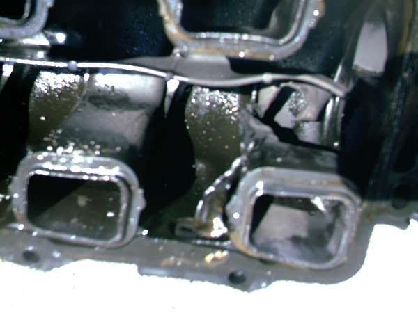

Buicks have a weakness in the upper intake manifold @ the EGR valve... usually melts through the coolant jacket into the intake and the lower intake gasket just comes apart...done way too many of them...just something to look for...hope you have good trip.. |

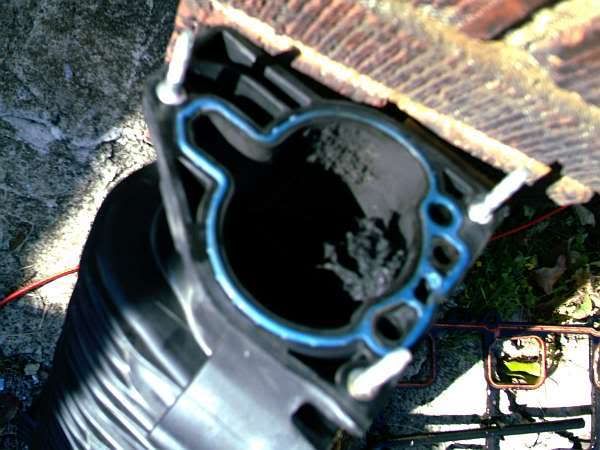

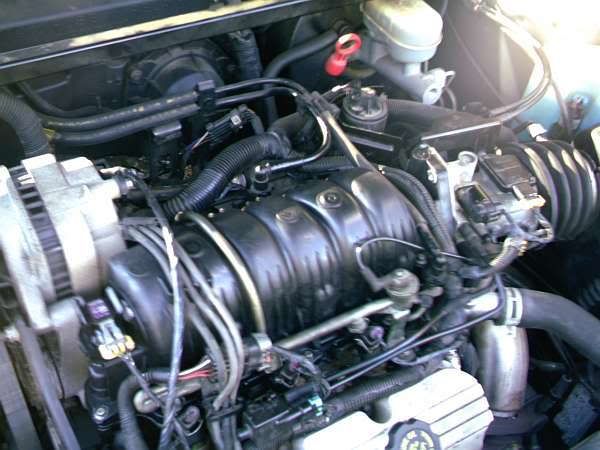

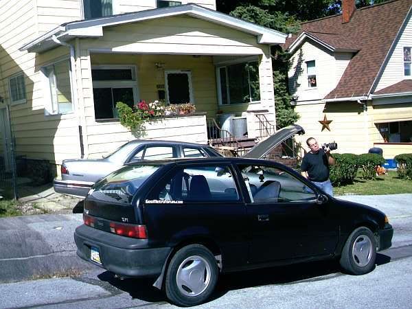

Here we are in front of dad's house and my brother cleaning the throttle body........![]() The plenum on the Buick was toast! This had to been going on for some time.......... ![]() ![]() Got it all fixed up and it's running great........

Are those wheels or just hubcaps on the black metro Johnny? |
| nerys | Oct 9 2010, 09:50 PM Post #14 |
Grr
hubcaps No "edge" and no "stem"
Edited by nerys, Oct 9 2010, 09:51 PM.
| Johnny Mullet | Oct 9 2010, 09:56 PM Post #15 |
Hubcaps from a 1995-1997 Geo Metro. They actually came off member pacopperhead's car when he replaced his with refabbed ones from ineedahubcap.com |
