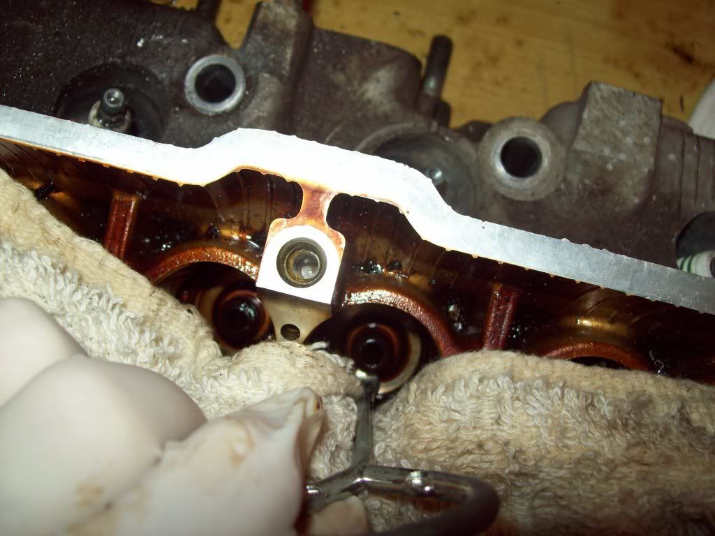

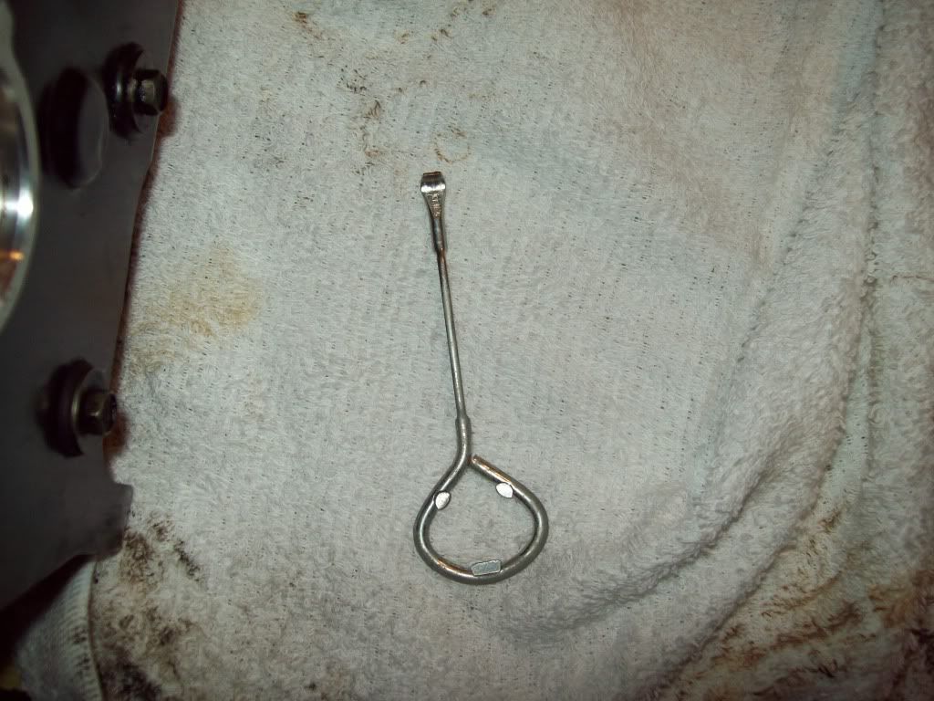

Hey folks. I don't know how helpful this is going to be, but I figured I'd pass it along. I have been messing around with this junkyard motor I got recently, and I've been reading on here. Well anyway, I read how much trouble valve guide seals can be to remove. So I started looking around my shop for a 'special tool'. I came up with this little guy
It's just a generic Home depot paint can opener, but it's perfect for getting under those seals. The lip of this thing is the perfect size.
I halfway stuffed a towel in the lifter bore so this metal tool wouldn't booger up the sides if I slipped. All I did was get under the seal on either side 2-3 times and pulled really hard, and "pop", the seal came right off. I'll bet if I got really creative with some threaded rod and 3 of these paint can openers I could build a screw type puller tool, kinda like a gear puller, only smaller. Maybe that can be tomorrow night's project...
Like I said, I don't know how helpful this is, but it seemed like a pretty neat trick at the time, so I figured I'd pass it along. I can see how you might wrestle these seals for a while with a smaller pick or something.
