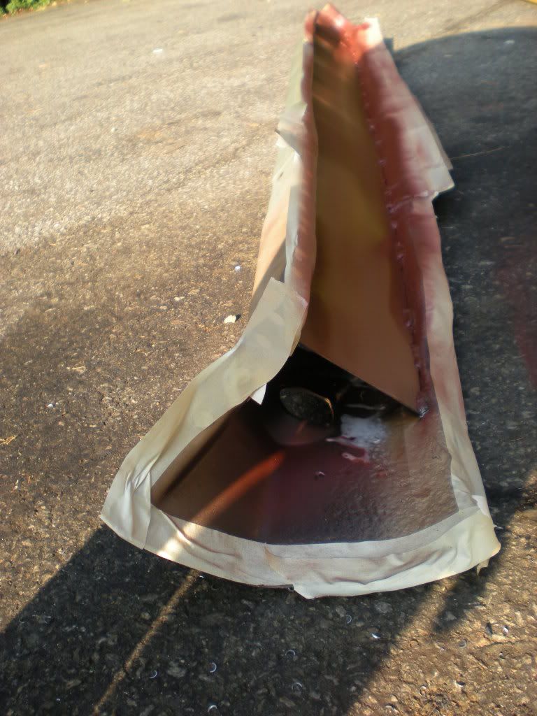

where did you get that rocker replacement? my vert could use some as well. You need to at least cut away enough material from the rocker to replace the inner member. The convertibles have an extra vertical piece of steel running through the rockers between the inside and outside for extra support since these lack the unibody roof. |
| mcmancuso | Oct 20 2010, 02:11 PM Post #5 |
look here, this thread over at teamswift is a great example of vert repair: http://teamswift.net/viewtopic.php?f=36&t=43375&start=75&hilit=plunge (you may have to join to see the pics, its a good metro/swift site as well) here's a shot from the thread showing the replaced inner member:
