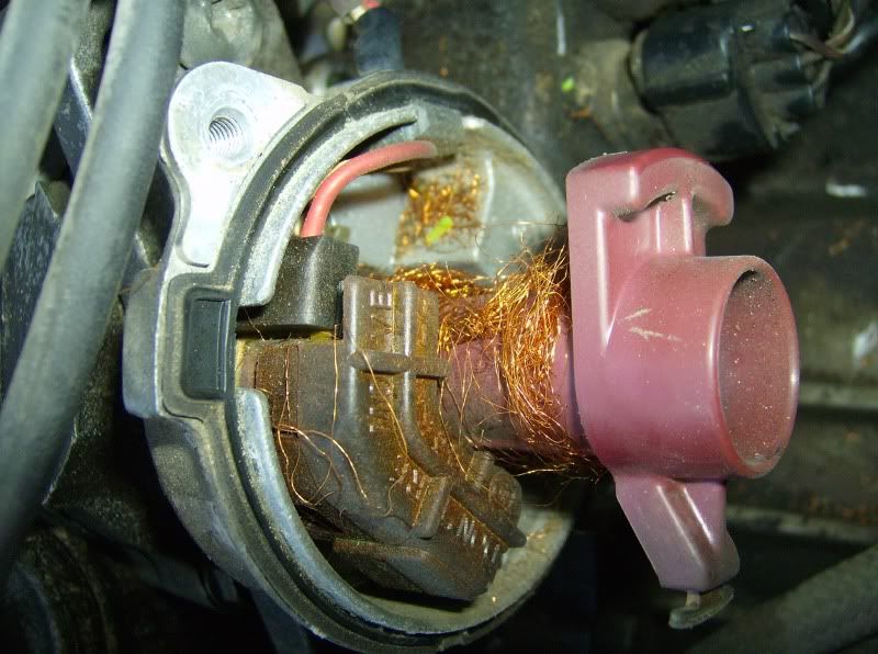

ok so i pulled the cap... and im pretty sure its not supposed to look like this O_O![]() ![]() ![]() ![]() 0_o |

I'm going to go out on a limb here and suggest you may have a defective distributor |
| Metro Blake | Nov 4 2010, 08:38 PM Post #9 |
Metro Lover
yeah pretty sure i do.... that winding went to the CMP O_O |

Well thats a first for me. I dont think I have every saw that malfunction before. At least you found the problem.

allrighty.. im going to pick up a dizzy from the junkyard tomarrow as i know for a fact that one is... well its toast :lol: so yeah gonna get that and a new cap and rotor! |
