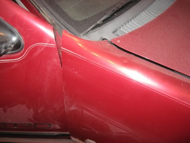

Has anybody successfully removed the Factory Pin Stripe without destroying the finish?![]() I've tried a little lacquer thinner. Nothing. A little rubbing compound. Zippo. Would like to take it totally off since most of it's just about totally faded anyway. But I'd like to retain what finish is there. |

If solvents won't budge it, you could use rubbing compound on a buffer. Even that may be slow. Carefully wet sanding it with a high grit paper (2000?) may be faster. Of course you'll need to buff it out afterward with a fine cut compound. Just found this procedure using oven cleaner: http://cleangsx2004.tripod.com/pinstripe.htm Looks promising. |

I'm assuming it's painted on, especially because of the curve it makes on the door. |

We still need to know: is it a sticker or is it painted on? |
| snowfish | Nov 27 2010, 10:01 AM Post #13 |
It appears to be painted on. Tried WD40, still the same, nothing. It's looking like wet sanding may be the only option.
