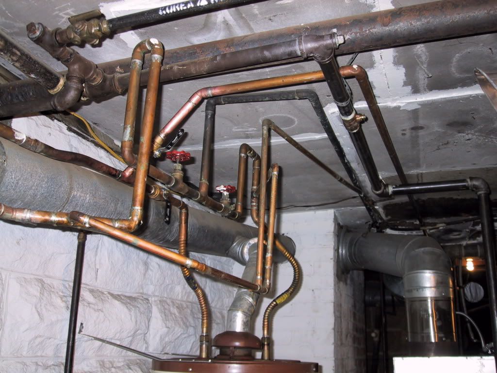

It's hot water was set up as a weird parallel 2-tank gas fired system. It worked ok, but not well. Then one tank went out (and the other was already on borrowed time).
So, instead of just replacing the dead tank with another, I installed a tankless on-demand heater (think it was around $500 on sale). Results were underwhelming as it was factory set to 122F--pretty much lukewarm. Not good for baths, dishes, or laundry.

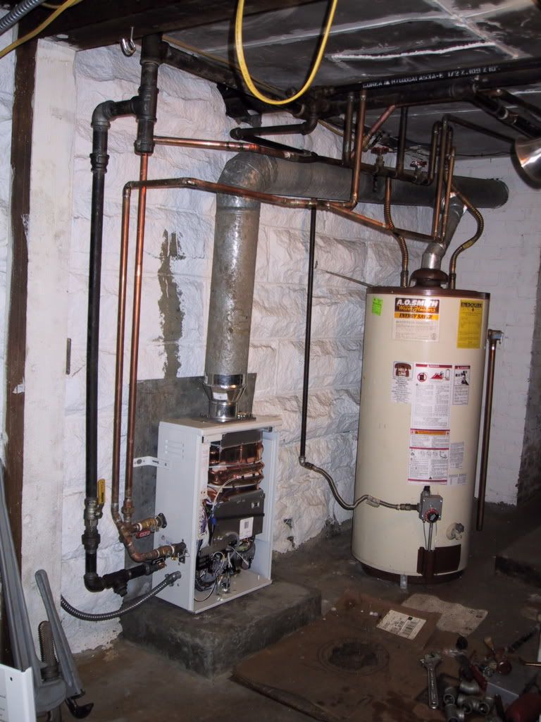

Just put them in series with the on-demand pre-heating the water going into the standard heater set at the desired higher temp. Has worked like a charm--never run out of hot. Four morning baths within an hour, multiple washer warm/hot loads, and dishwasher (before it broke!)--no problem! And without the shock of cold water entering the standard heater, it's still working 15 years after the warrantee expired.

Here's the funky old piping I ripped out--weird!
On-demand unit, faceplate off:
New piping--just flip 3 shutoffs to take either unit offline:
Whole setup:
