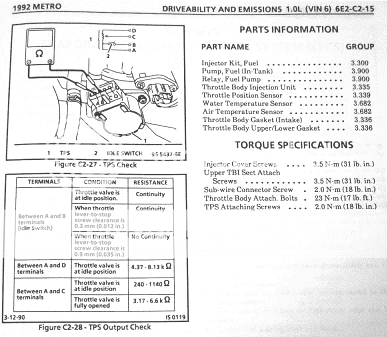

Check the idle switch, pins A & B, this image is a good reference:
Here's a relevant thread.
http://geometroforum.com/topic/1341780
Checking pins C & D is a major waste of time, accurately measuring resistance on this part is next to impossible.

BTW, the FSM page (regarding setting the TPS) that zcrayfish posted on 2/1/11 is for a '92 and will not work on your '95. Your '95 TPS has 4 pins but only 3 are used: A,C & D (A is nearest the firewall). Instead of hooking your meter to A & B as shown, you need to hook it to A & C.
But what about your ISC findings?
