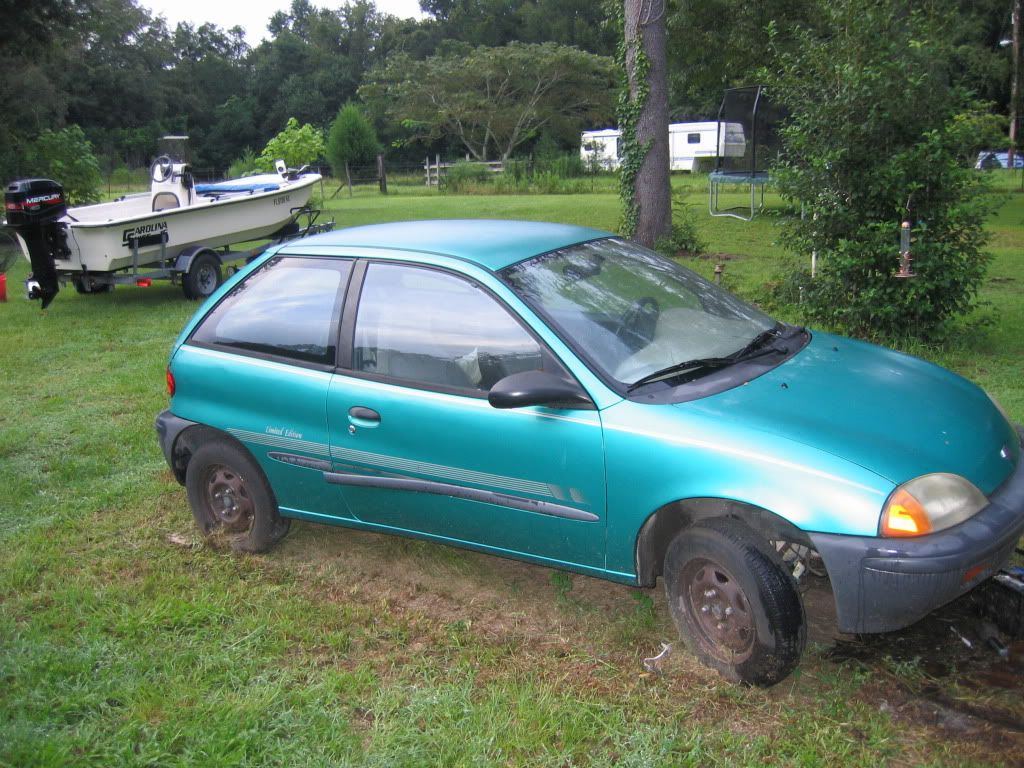

The car a 95 Lsi 2 door:
My wife bought it years ago before we met. When our son was born we got something a little safer for
her to drive.
Like most of us I had gone through many vehicles, 59 Chevy, 65 Newport, Mustang, a few trucks. For some reason the metro hung around.
At some point I started driving it for a daily commuter or should I say daily abuser.

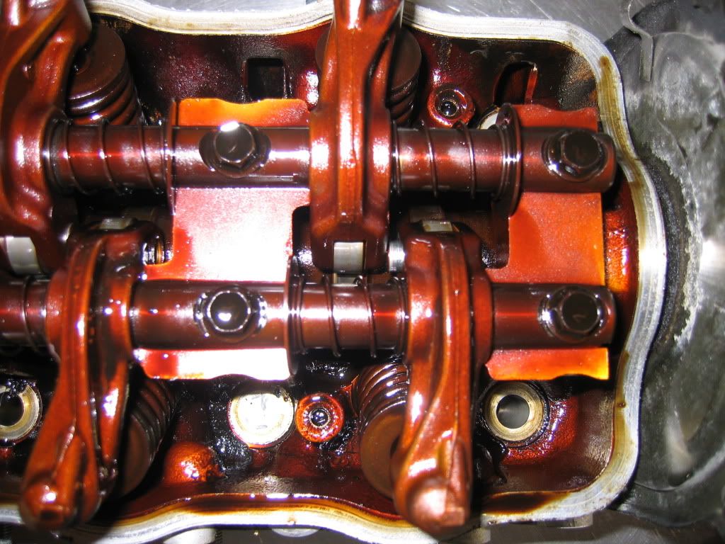

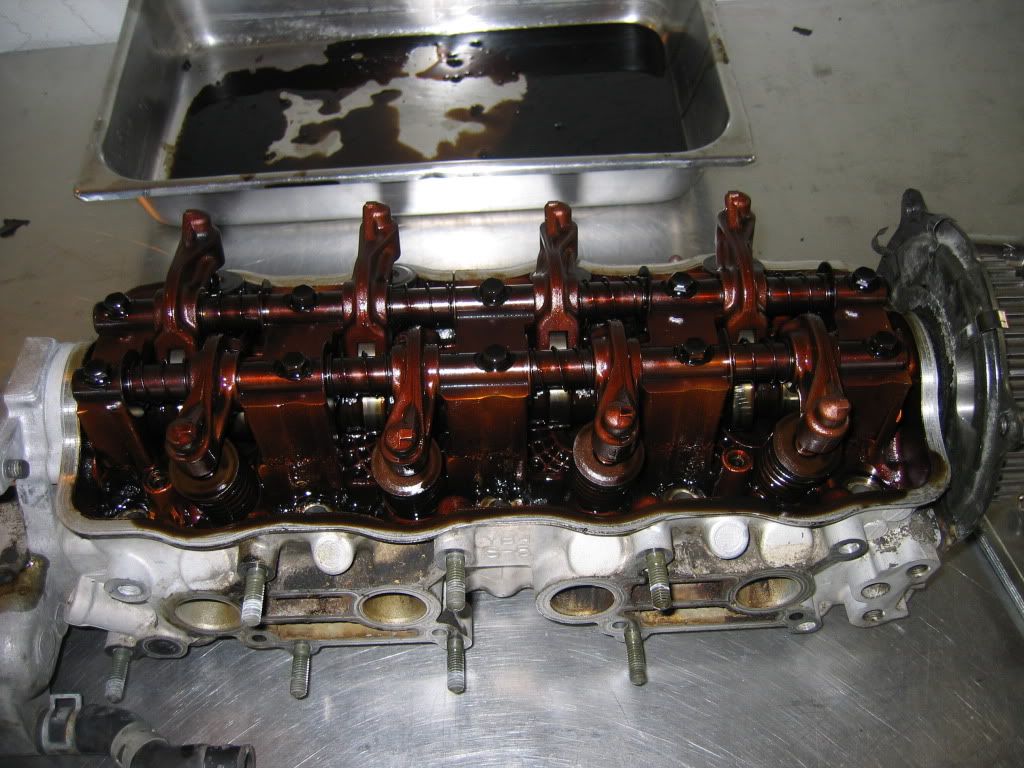

I pulled the motor and found this
http://i748.photobucket.com/albums/xx126/shallowshannon/IMG_2456.jpg
http://i748.photobucket.com/albums/xx126/shallowshannon/IMG_2427.jpg
http://i748.photobucket.com/albums/xx126/shallowshannon/IMG_2430.jpg

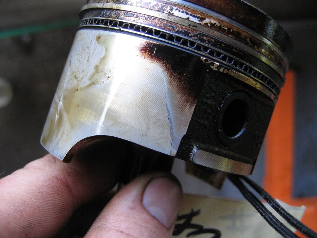

Cracked pistons (all 4), lots of sludge, and a bit of a warped head among other things.
I ordered new pistons, rings, gaskets, and a long list of other parts.

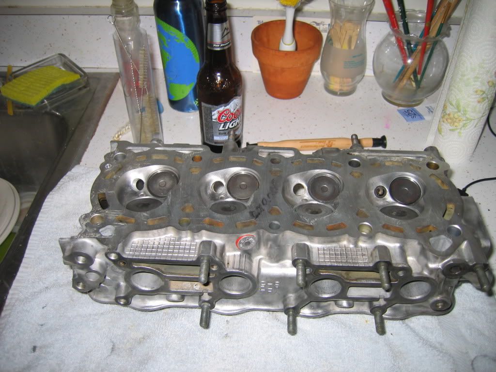

The valves weren't burnt so I decided to reuse them.
Lapping them in on the kitchen counter.

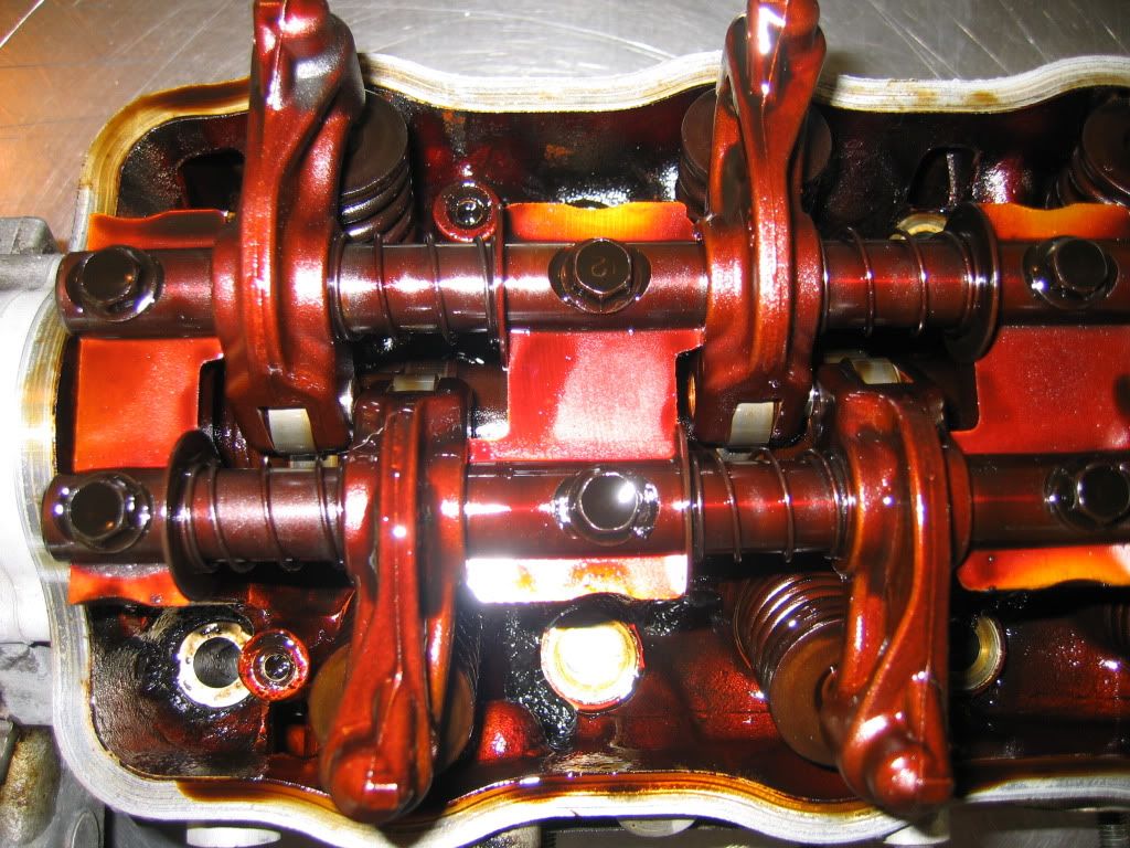

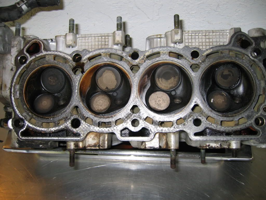

Like I said before I didn't document the build like I should have but here are some pics of what it looked like before hand.

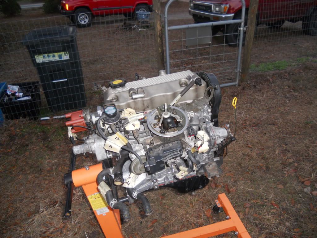

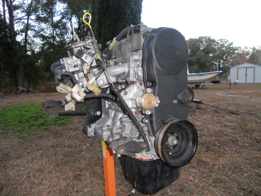

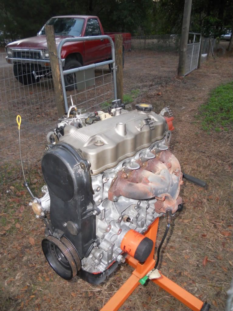

After a bit of cleaning and assembly this is it on the stand. It's not as clean as some others I've seen on here
but I do plan on giving it one more wipe down before its installed.
Still need to get some hoses, vacuum lines and a few things like that but for the most part it's ready to go.

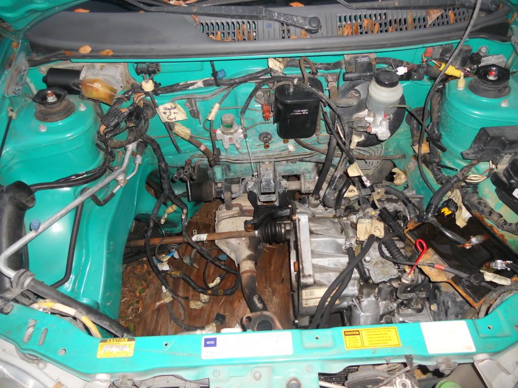

A shot of the engine room, need to do a little more scrubin but hope to have it shiny before install.

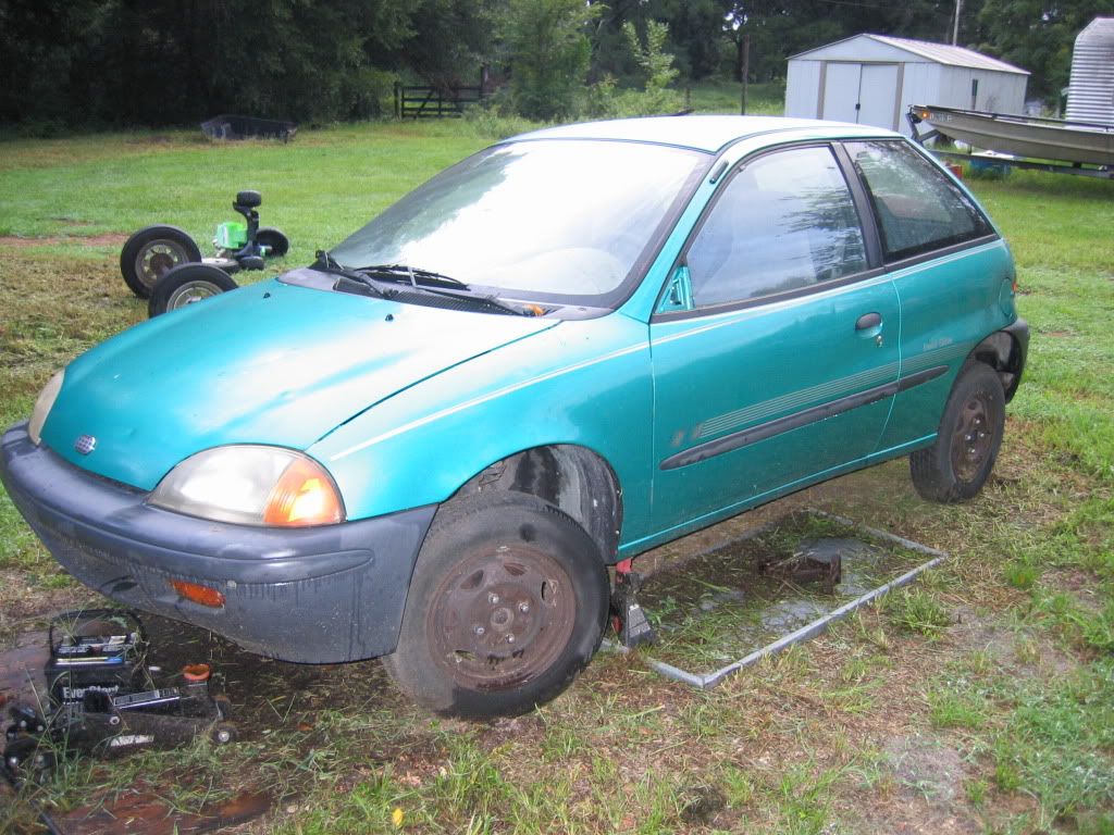

And here's a couple of the exterior. I plan on taking care of the cosmetics after she purrs for me.
