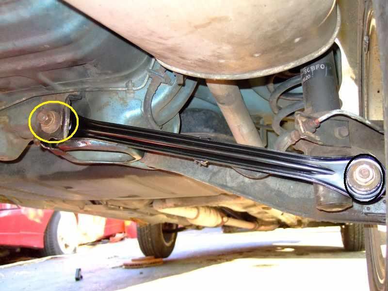

i'm replacing the spindles on the rear and can't get the darn control rod off(BLACK CIRCLE). I gave up for the day and plan on tackeling it in the morning again. I need help getting this off! It seems like theres another nut or somthing holding it on. I try to pry it off and the rubber flexes. If i use heat, i'm afraid of ruining the rubber on the Rod. I can't afford buying a new one either. I also tried taking off the nut on the other end (YELLOW CIRCLE) and the nut will come off but the bolt wont budge! :hmm HELLLLPP!

Hey WKP! I'm getting ready to replace the control rods on my ride on Saturday. I'll check the FSM in advance and see what the procedure is. By the way, there's a big "O" spring involved there. Be careful. I'll find the pages, and let you know. Looks like you got the outboard nut off. Good start. The inboard nut has an adjustment cam for your rear wheel toe. You don't want to F with this one, if it's set.

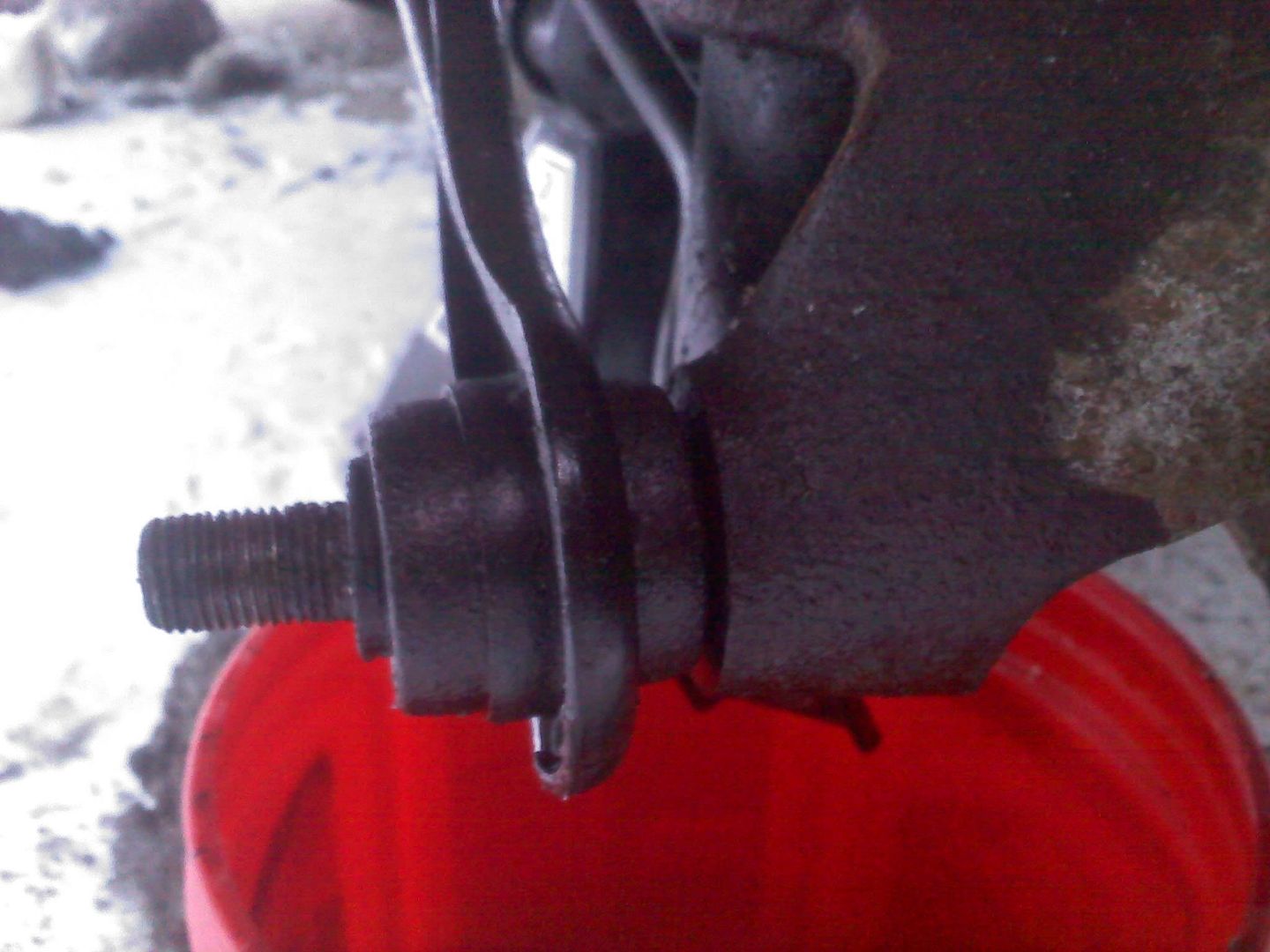

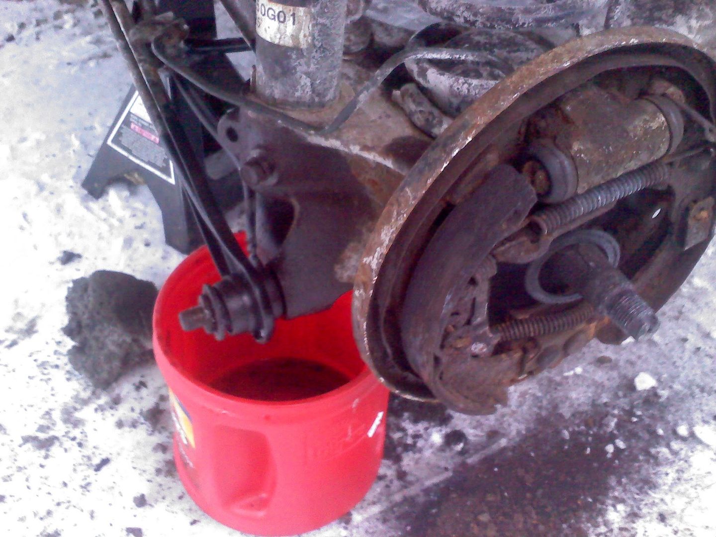

It is rusted on and stuck (welcome to the Great Lakes) and you need to use striking force to remove it. Use lots of penetrating oil (black arrow) and let it soak, strike spindle area behind rod a few good times to loosen any rust and soak more. Then use a big freaking hammer and strike the rod in the direction of (white arrow) and repeat. A few dings won't hurt it. If you have a wide, dull chisel you can wedge in there and strike it to get it moving it will help.
Edited by Johnny Mullet, Feb 11 2011, 06:18 AM.

Glenn: Where did you get the factory service manual? i could really use one of those! Also, the other guys said that i could just "pop" it out. What inboard nut are you talking about?
Johnny Mullet: Where should i strike the spindle at? are you talking about the opposite end of the treads thats on the cast metal part? And what arrows are you talking about.

Yes, strike the cast part. Believe it or not, the shock from doing this a few good times will help.
Arrows are on the pic I forgot to post. It's up now.

One of your primary problems will be this. The control arm has a rubber bushing on each end. inside the rubber bushing is a METAL BUSHING that slides over the rod and within a bolt (inside)
when I did this the METAL BUSHING STAYED BEHIND preventing me from installing the new one and even REMOVING the inside connection.
the only way I could remove mine was with a GRINDER. I had to grind away at it till I was able to tear away the sleeve doing as little damage as possible to the car mount and BOLT.
Another method is a torch but the BLUE gas is not hot enough you need to go with the yellow bottle (MAP gas) USE CAUTION this gas CAN AND WILL melt metal on this car !!
I heated the bushing till it disintegrated heated the control rod till I could tear it up and remove it.
I then took the angle grinder to the metal bushing until is was compromised enough to get go.
install the new control rod took 60 seconds :-) USE anti seize.
