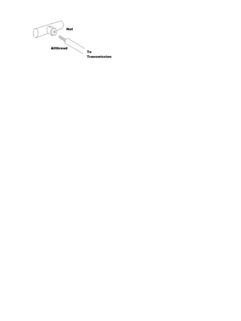

Suppose I cut off the end of the shift rod about 2 cm from the "T" that connects to the stick.
Welded a male threaded allthread to the end that I cut off.
Pulled the boot.
Can I then pull the seal and replace it, since there wouldn't be that "T"?
Then welded a nut onto the 2cm shaft remaining on the "T". so it would thread back on to the allthread and make the shift shaft a unit again.
Here's my attempt at a drawing of what I am trying to explain. It seems to me that the seal would slide off the outside end of the shaft this way and a new one could slip back on. Then, thread the "T" onto the shift shaft, snug up the boot, and bolt up the stick linkage.
Please feel free to give feedback. Rip it to shreds (pros, cons) so we can see if it will work or not.
Welding the allthread would take place before slipping on the new seal to prevent cooking it.

That is a creative idea.
I have a spare shifter rod I'll send you so you can try it out....if you want to try it.
Let me know.

The constant rotating back and forth of the shifter during shift action will back off the threaded section. If you rewelded it after install it might work.

Great feedback, thanks. I'm looking for negative feedback so I can figure out if it will work before attempting it.
I don't see how it could it to back off (or thread in further) since both ends of the shaft are fixed, one end is bolted in the transmission and the other end is bolted to the shaft that goes on back to the stick shift. Threadlock should omit even any wiggle that might occur.
Yes?
