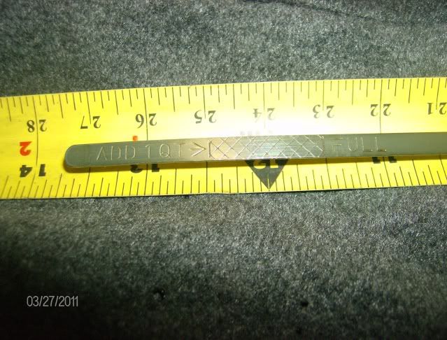

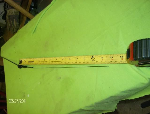

My dipstick is slightly longer than 96Geoman. I have a 1993 Metro 1.0.![]() 13 3/4 inch or 27.5cm long for the business end. ![]() Just a close up of the very tip. ![]() A better close up showing the crosshatch for oil depth. 23cm to 25cm = 1qt of oil. A link to all the pics I took in case these are not enough. Dipstick pics @ photobucket |

I just found my 1996 dipstick. I replaced my 96 1.0 with a 93 1.0 but kept the 93 dipstick. I compared both dipsticks. Both dipsticks will register correctly in the 1.0 engine The 1996 dipstick is longer than the 93 dipstick The only differences are: the 1996 dipstick has a longer handle the 1996 dipstick has a longer blade (about 1/2 inch longer so the words 'ADD 1 QT' can be stamped on the blade. Also has 'FULL' stamped above the fill mark) the 1993 dipstick has 2 small holes in the blade to show the full mark and 1 quart low mark. |
