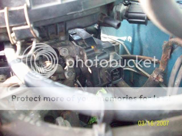

Ultimately you have to have the correct tb for your ECU and wiring harness. In 94 both the top and bottom pictured tb's were used. (I have 2 94's, one with each style of tb pictured). So it is very possible that your 94 engine came with the bottom pic'd tb from the factory. The tb in the bottom pic was used on some 94 3 cyls and all 3 cyl models from 95 up. So work car is correct, you could get one from any 95 and up 3 cyl. If you're worried the mani (and required tb) dont match your ecu/wiring harness then you need to go off the ecu to figure out which tb (and thus mani) you need. I guess you could go off the numbers on the ecu but I'd probably just try to figure out which would match the wiring harness. The bottom pic's tb has an idle speed control motor hanging off the back of it. The top pic's tb does not. So if your wiring harness has a plug for an idle speed control motor then you need the tb in the bottom pic. Here's a pic of the idle speed control motor. If your wiring harness has a connector that'll fit the plug in the black box of this pic (the other style tb wont have any plug even close to this) then you need the tb in the bottom pic of post #1. Hope this is decipherable and helps. Edited by duff_remle, Apr 2 2011, 10:51 PM.
