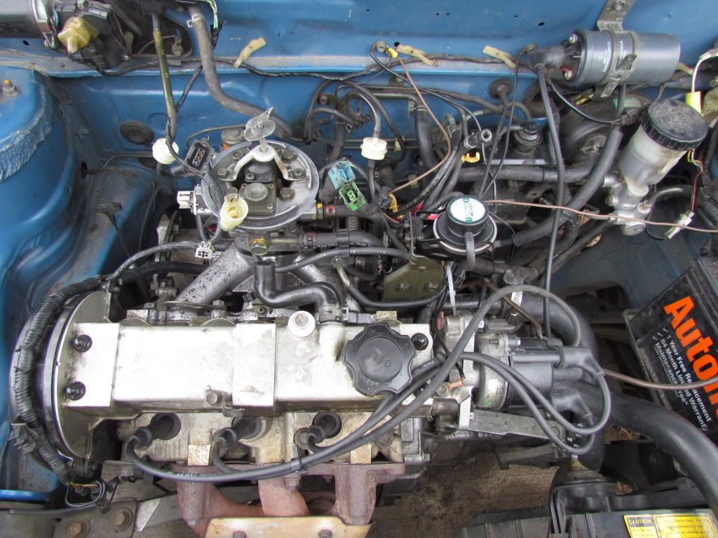

i finally have pictures of the intake/carburator and intake/throttle body at photobucket.com/shyann22 the carburator was on it when i bought it and it has to run an rpm at 2800 rpm or it will die. i hooked up the throttle body as you can see in the pictures and i have all the loose connectors there to view and i can't find anywhere they could possibly go. and please tell me if i'm wrong but aren't those one connectors fuel injection connectors that hook onto a fuel injector. the car won't start now and it doesn't seem to be getting any fuel or spark. and could someone please tell if that throttle body from the 95 is actually interchangable with my 91 thanks again to everyone whos helped me with this

My guess would be that you would need a 1995 computer and you would have to install a MAP sensor, and there could be more.

I could snap photos of my 95 TBI and a 94 TBI if that would help any? I don't know much about them but I DO know that the TPS's (throttle position sensors) are different and so are the wiring harnesses that connect to them (the 95 has 3 wires and the 94 has 4 wires).
Let me know if this would be any help and I'll try to get to it Monday.

Can you explain the pictures for us?
